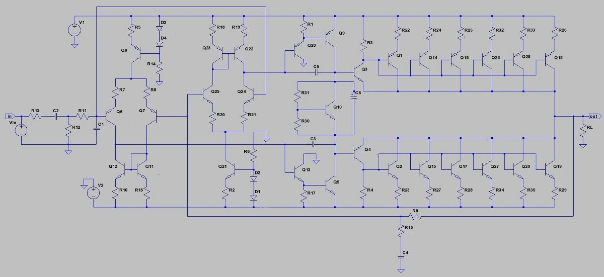

I was playing around with a power amp design in LTspice recently. It is astonishing how quickly things go south when you drop the load resistance from 4 ohm to 2 ohm. To drive a 2 ohm load requires symmetrical input and voltage amplification stage to avoid asymmetric clipping (positive half of wave clips at far below the supply voltage). In addition to to the big transformer, lots of output transistors in parallel are needed to switch all that current. Here is what I came up with before I decided that it was not such a great idea. I already have a device with a big transformer that converts electricity into heat and sparks. It is called a welder!
