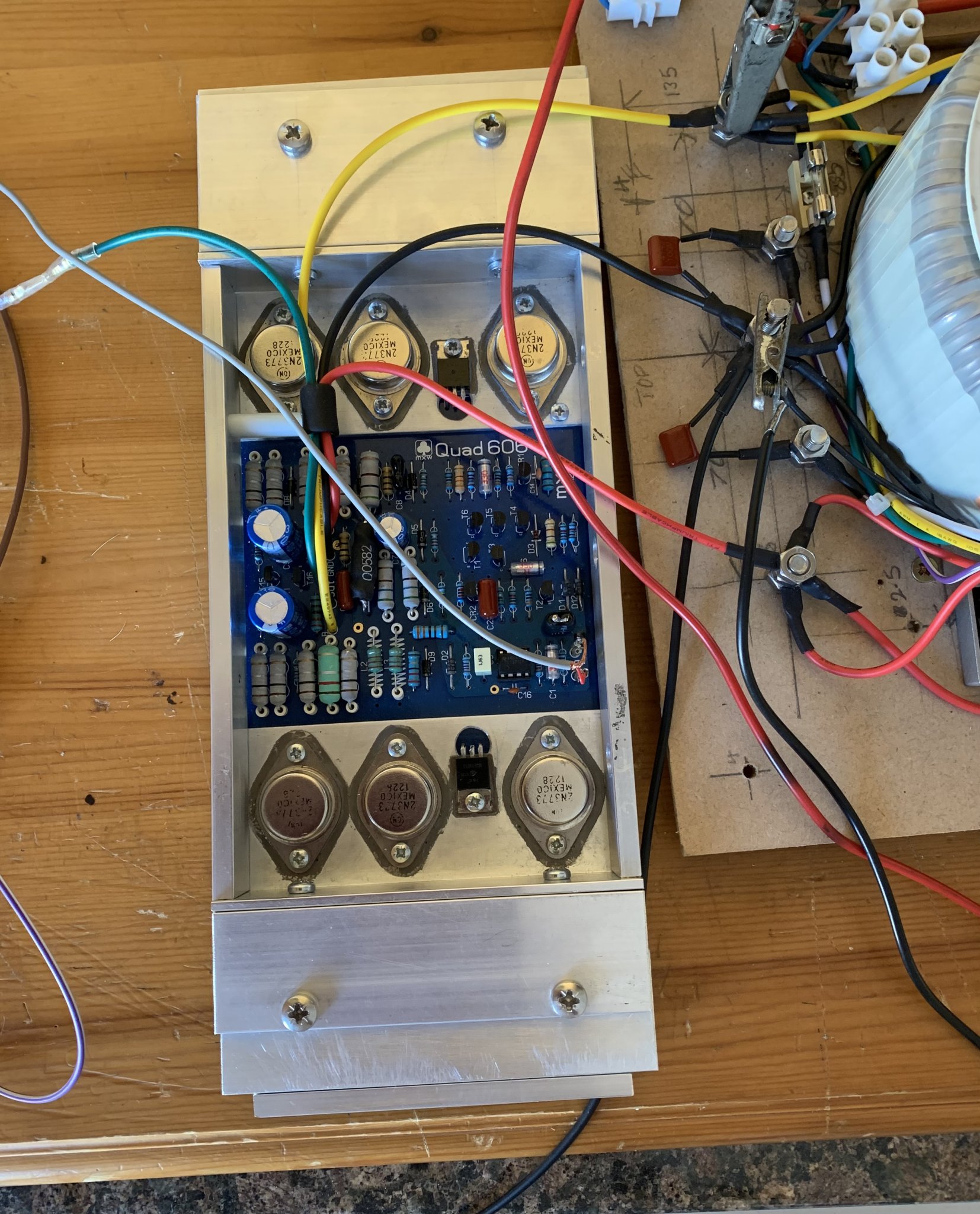

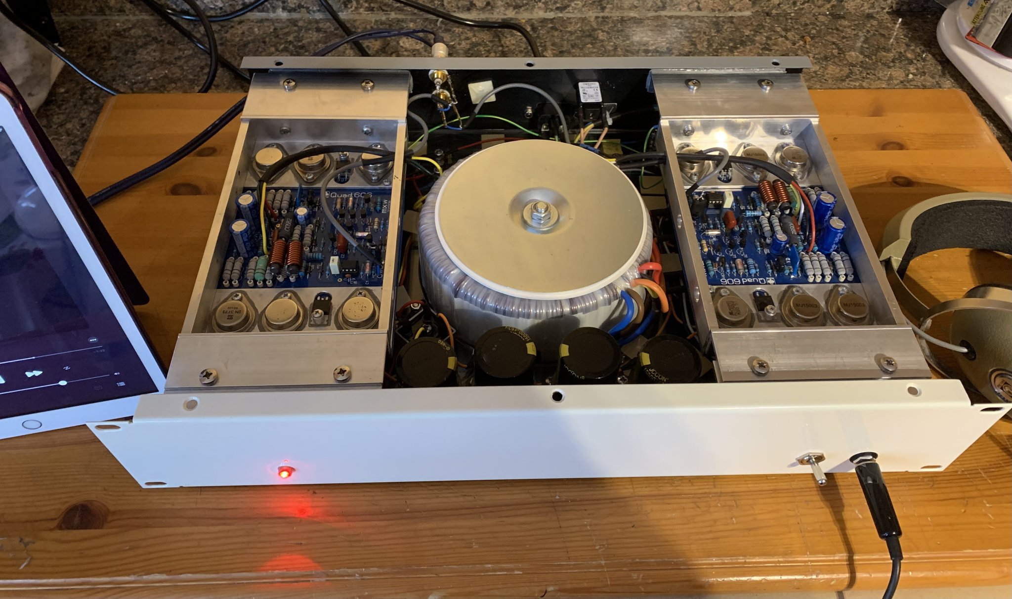

Quad 606 clone oscillating

The 606 is a "current dumping" amplifier, similar to the original 405. Thermal stability is inherent, but frequency stability is another matter.

Key features are: the current dumper transistors operate as a crude class-B output stage (zero standing current); an agile, low-power, class A output stage contributes current as required to minimise crossover distortion, all via a C/L/R/R bridge. More feedforward than feedback, really.
Anyway, this sounds pretty tricky. I wonder if the oscillation is caused by the emitter-follower dumpers self-oscillating? You could always try adding base stopper resistors, close to the transistors.
Good luck!

Oscillations will vary, depending on the capacitance added by the heat sink between the transistor and ground.
The isolation pad is the parasitic capacitor's dielectric. You may have to reduce the bandwidth earlier in the
circuit by forming a dominant pole there, to reduce HF phase shift enough for stability.
If you are not grounding the heat sink(s) at all, scrape off the heat sink finish in a spot, and add a ground wire.
In that case, this may very well fix the problem.
A while ago I built a Quad 606 clone using MJ15003 output transistors. One channel works perfectly but the other channel oscillates.
One possibility is that the choice of output transistors might be the cause of the problem.
Did you find the cure for the oscillation?
The same thing happened to mine and the problem was cured by altering the value of R8 which governs the current in part of the circuit.

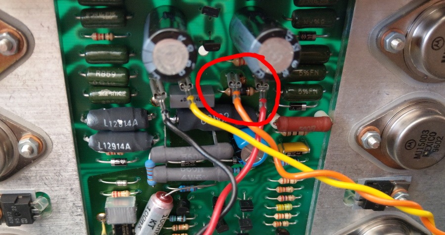

For what it's worth.... here is the Quad 606 from a friend of mine, and it developed some hum accompanied by hiss, on one channel.
Closer inspection showed the resistors in the output zobel network were grilled (R33), on the defective channel it did not measure 10 Ohms but 50 KOhms.... Judging by the color of the other channels' resistor, it was not far from giving up as well. They only lasted 30 odd years 😀
Replaced both, no more hum and hiss, playing happily !

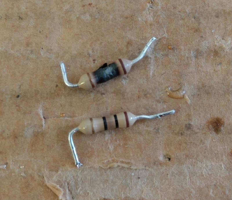

During the building of my 606 clones I found several resistors stated by Quad to be .25Watt were showing signs of overheating. I upgraded these to 1Watt and it’s been working nicely for 2 months now.
