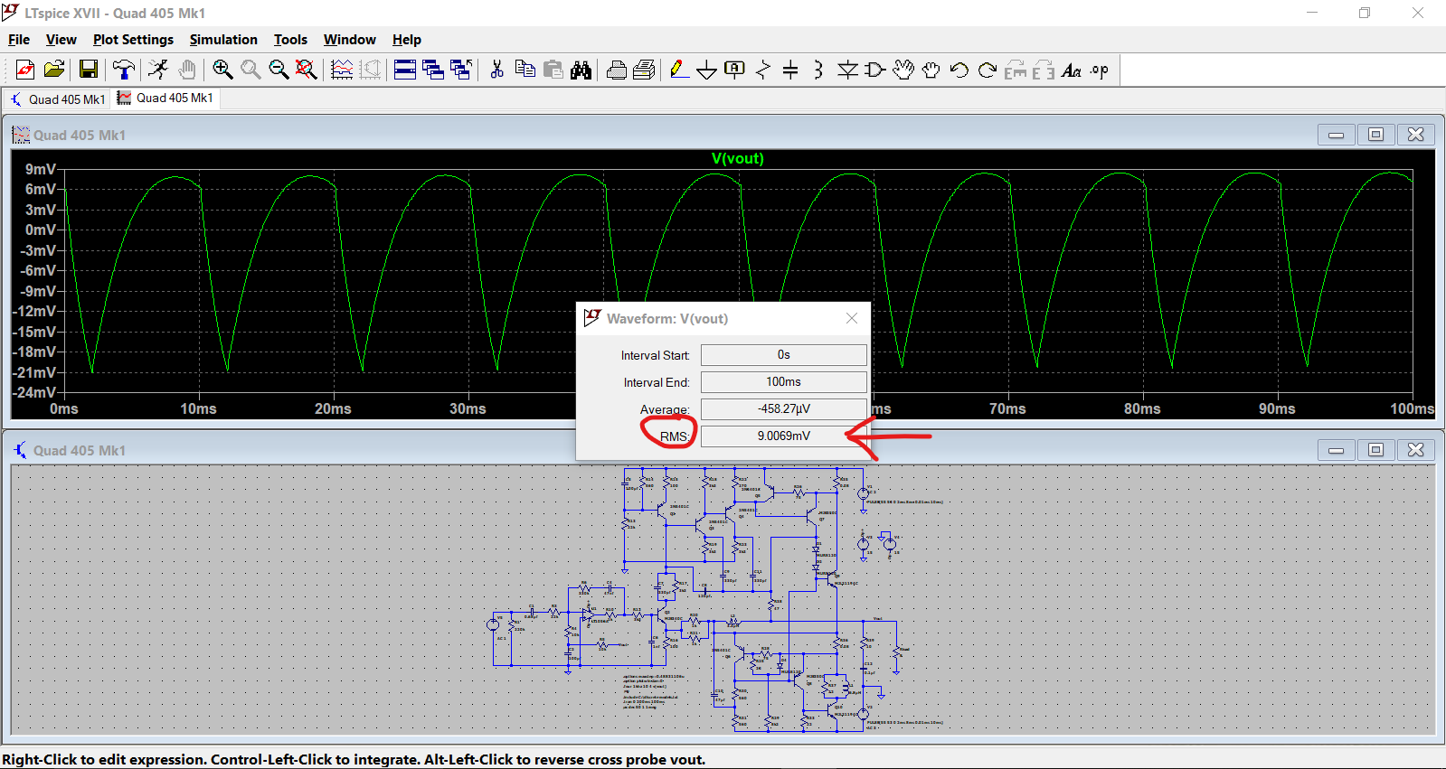

Can anyone say what the residual mains hum should be in a correctly working Quad 405 power amplifier, measured across a specified load (say 8 Ohms, RMS or Peak voltage) with the input open circuit? I have not found this information anywhere. It would help to know when to stop trying to fix it!

It is possible this could be caused by deterioration of the main reservoir caps. I have the 405 set up as a simulation (never looked at ripple rejection before) and it seems that as little as a couple of volts ripple will generate the kind of levels you are seeing.
The injection mechanism seems to be via the positive rail rather than negative.
This is with 2 volts peak of ripple on each rail (making the negative rail pure doesn't change the result).

Mooly: I had indeed expected deterioration of the main reservoir caps, which is partly why I asked the question. Thanks for the simulation.
