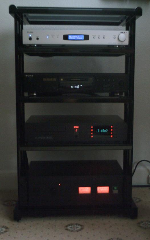

My system --- unchanged for years because I am so pleased with it,
MOSFET amp --- in these forums 😉 Just wish someone with a top flight system would build it 🙂
Micromega Stage 2, sensibly tweaked.
Pure DRX701
Good old Sony Minidisc !!
B&W 703's -- Wonderful.
Edit, just looking at your pictures. They are a real credit to you.

Cables, nothing very exotic, for the interconnects I use some leads I got from CPC ( They are local to me) which I have shortened. At the time they were a "best buy" recommended by one of the popular mags. I do have a "Chord" phono interconnect but these are every bit as good.
Speaker leads - again from CPC - OFC Type made by Pro-Power, now these are good, and very flexible as well. Fortunately I only have a shortish run from the amp.
As you can probably see from the pic, I don't like to see cables 🙂 .
All the power for the source components is from a small box on the wall behind the amp, right next to the wall socket. The incoming mains is fed through a high current relay (I know 🙂 , they must draw all of 20 watts on together) that is switched from the amp. The signal to the box is via an opto (TOSLINK) interconnect, and the box gives a 2 minute delay when switching the amp off. Just enough time to remove a CD or finalise that Mini Disc before the power goes. There is a manual overide as well so you can record of the tuner without the amp being on if you want.
I must try some of the later OpAmps available-- when I modded the MicroMega I used OPA2604 (Used OPA604 in my amp) and AD845's. I found these very musical -- notably so.
