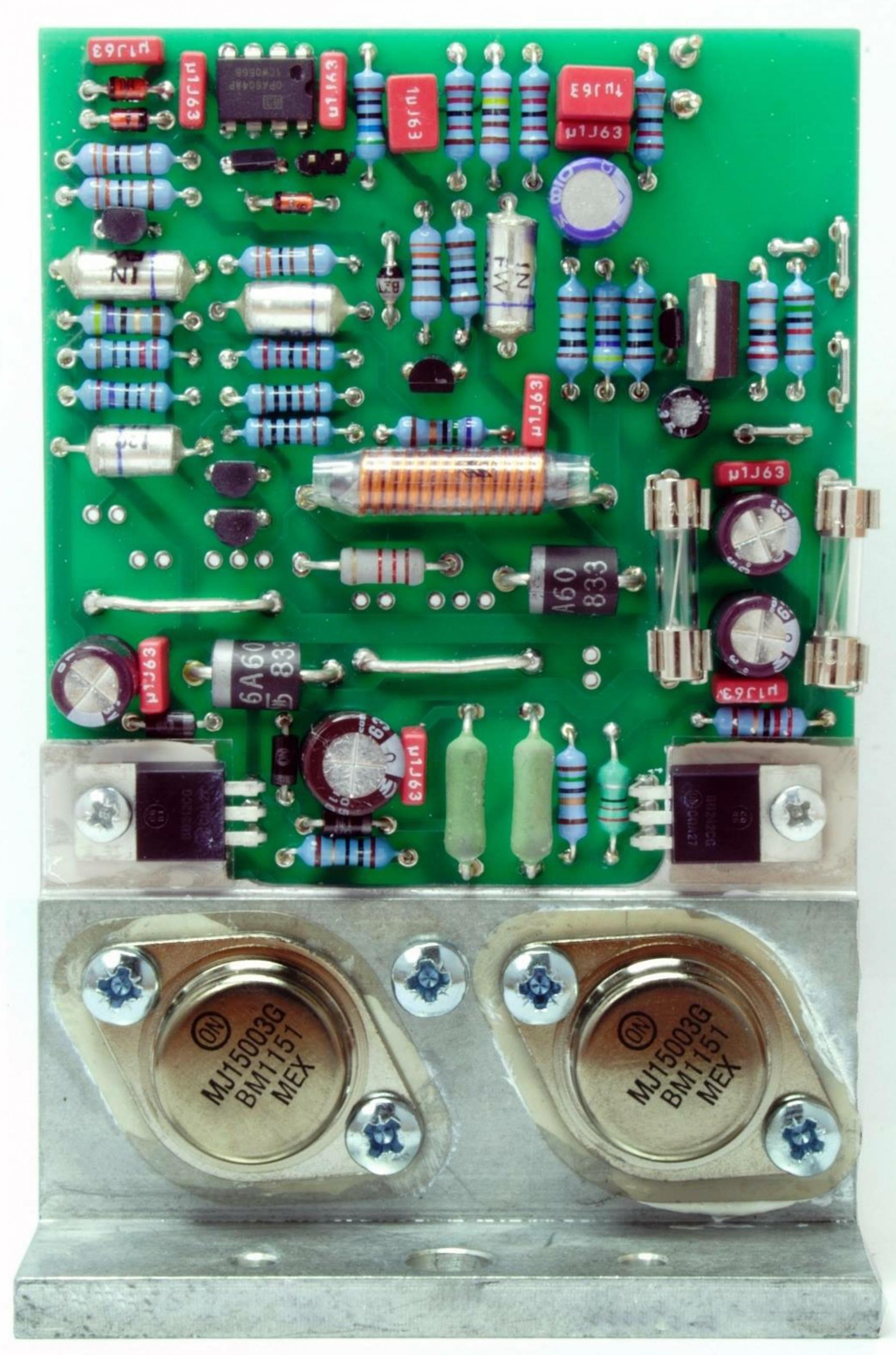

For the asking price, you won't go too far wrong. The polarities are probably down to copyright issues.
These might be a better bet
Higly sought Class A dynamic biasing 80W amplifier PCB Quad 405 MK2 1pc ! | eBay
I suspect they may be copies of a Dada board.

the fact that the first link claims ClassA tells you they know nothing about what they are selling.
What will their customer support be like?
The second link shows a PCB and sch and the sch seems to have been highlighted to show what is on board and what is off board. And still claim ClassA ! and can't spell highly.
I would go for the second, but don't expect any customer support from someone who has stolen QUAD's I.P.

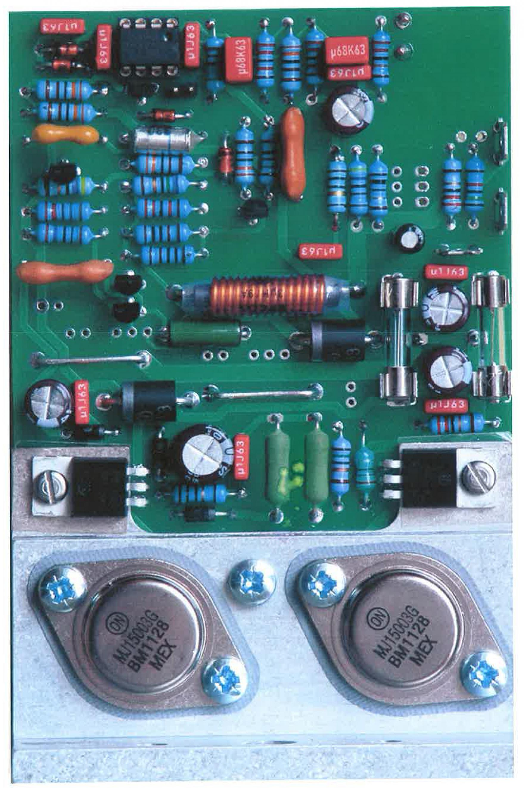

Hi Colin
I think you may find the eBay after-market Quad 405 boards from China
are larger than an original board pair, and will not fit in an original casework for a 405.
There is however a specific Quad 405 case made for them available
which is black and a bit bigger.
From my experience the Net Audio Mk3 boards are a very good indeed.,
Cheers / Chris

Thanks for all the input; I have gone for the ones from Jim's Audio - they look very similar to a pic I found of the Dada board, just a few subtle differences.
I did like the look of the Net Audio boards, but I cannot justify spending that much(That and I fancy having a go myself).
Attached is a pic of the Dada board and also a completed board from the Ebay vendor.
Colin
