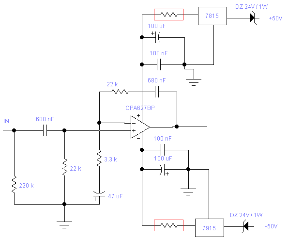

Now that you have the supply working you may want to consider running a resistor Zener//cap AFTER the regulator. An experiment that may sound better.
I had to run 24V Zenners before the 7815/7915 regulators because their max voltage is +35V/-35V.

do you really have a resistor in the Vrail feed to the opamp after the regs? This will kill effective regulator action.
I am suggesting that the the opamp MAY operate more cleanly if a zener stabilised voltage was fed to it rather than the dirty PSU voltage that comes out of these one chip regulators.
The easy way to achieve this is to add an extra regulating stage after the 7824 & 7924. The extra stage would be a dropping resistor (270r) and Zener (15V 500mW). This would provide about 30mA of peak current from the Zener and any additional current demand from the opamp would be met by the decoupling caps.

the ground symbol on the input side looks the same as the ground symbol on each of the regulator and decoupling returns.
Have you returned each of these grounds SEPARATELY to your central ground? Otherwise you may get contamination of your input signal from ground rail modulation. I wonder if the hiss you heard comes from here? or is it simply low level noise from the gain of your circuits?

No, I haven't returned them separately to my central ground and I'm susspecting that this is the cause of the faint hiss.
Maybe the regulators are ok as they are and I don't need any extra regulating stage but a separate ground return for the decoupling caps and the regulators.
This faint hiss is not the low level noise comming from the amplifier's gain. I changed the regulation stage because of the higher current need of the OPA627. Before of that the noise could be heard only if you sticked your ears to the speakers, especially after appling the non inverting design for the input.
Using the original regulation design for the OPA627 the sound was suppressed (maybe is not the right word), especially listening to piano (Keith Jarrett) the tail of the notes were clearly distorted and the resistance's R7 and R8 and zenners were getting hot after a couple of minutes.
That's why I tried the regulators for the input as in tvicol's design:
http://www.diyaudio.com/forums/showthread.php?s=&threadid=51036&perpage=10&pagenumber=2
I have to try to separate the regulators and decoupling caps return from the rest of the input. Thanks.

I missunderstood what Andrew wrote in
In the quote he suggested to add an extra stabilizing stage using a dropping resistor (270r) and a Zenner (15V 500mW), but first if all I will try to hard wire the dirty returns toghether and run them to the central ground.
Zsolt
I drawed the resistor in the red sqare just to ask if that is what he suggested, but no, I do not have any resistor there.Now that you have the supply working you may want to consider running a resistor Zener//cap AFTER the regulator

Thank you guys,
I was able to resolve the hum/noise problem 🙂 .
The first noise problem was that I haven't connected the input sockets to the chassis directly at the point they were mounted.
And, indeed, the faint ssss noise in the speakers was due to bad grounding of the regulators and decoupling caps used by the input operational. Hard wiring them to the central ground removed the faint hiss too.
