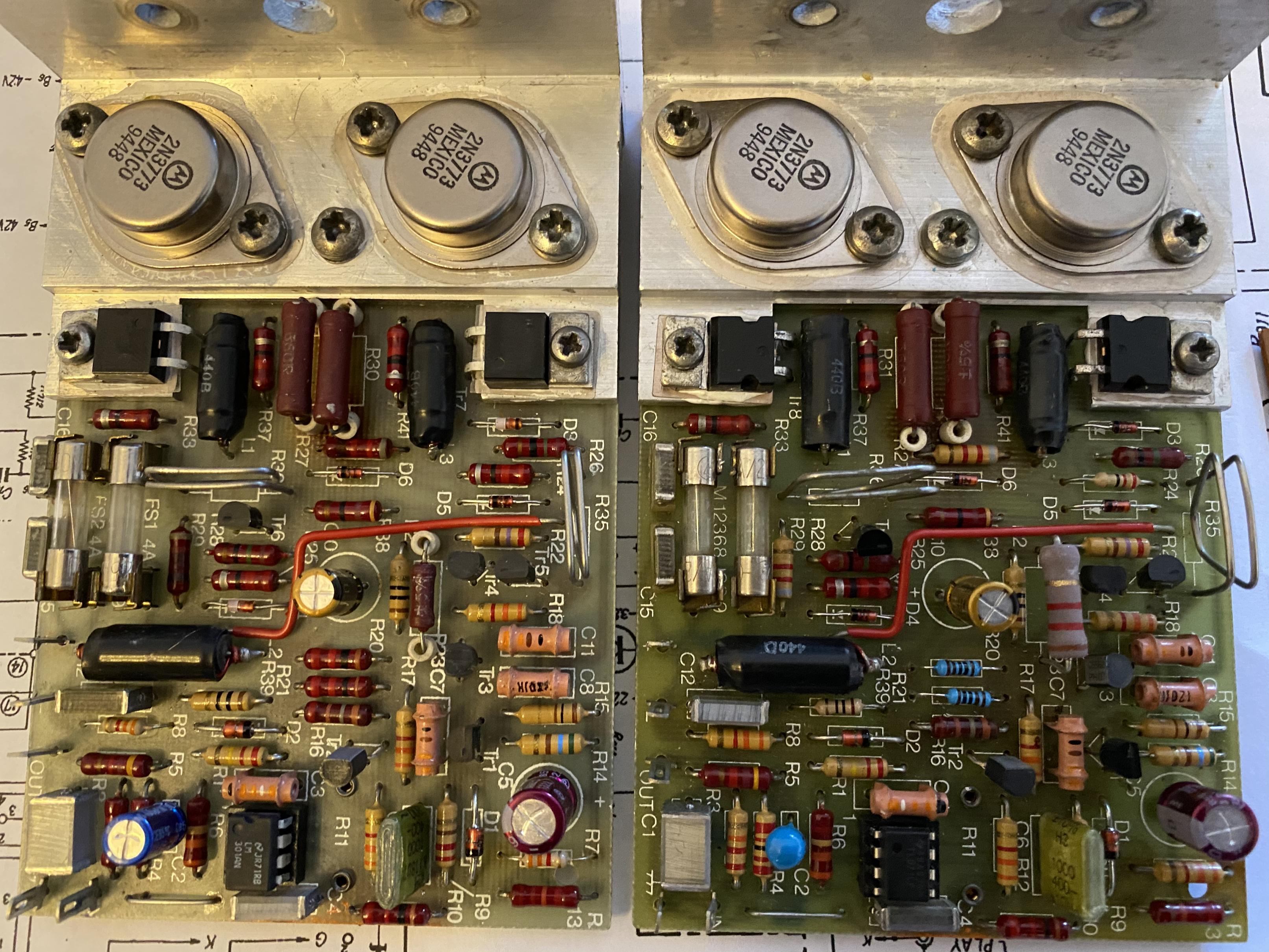

Hi everyone,
I recently refurbished a faulty Quad 405 amplifier. I replaced all transistors, electrolytic caps, diodes, zeners , out of spec resistors.
However, one of the board sounded heavily distorted and weak while the other one sounded ok. I swapped the boards and found the same board still distorted and weak when shifted to the other channel.
I carried out an exhaustive check and sis not find anything abnormal with regard to pcb tracks or components. Nevertheless I replaced once again the diodes, zeners, transistors and also swapped the inductors with the other board. I also swapped the ceramic capacitors
But the problem was found to persist.
Can anyone please advise me in the matter
AL

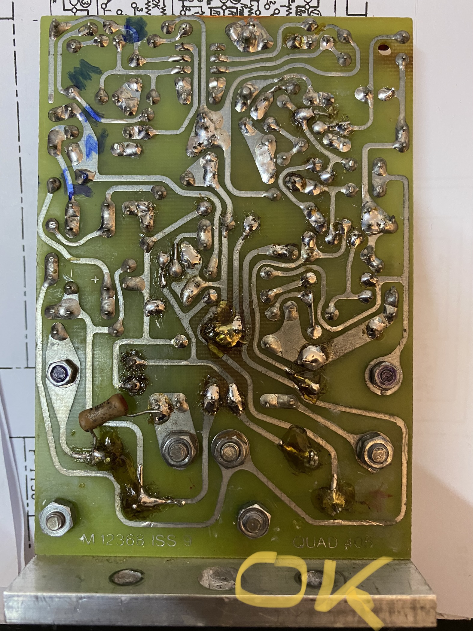

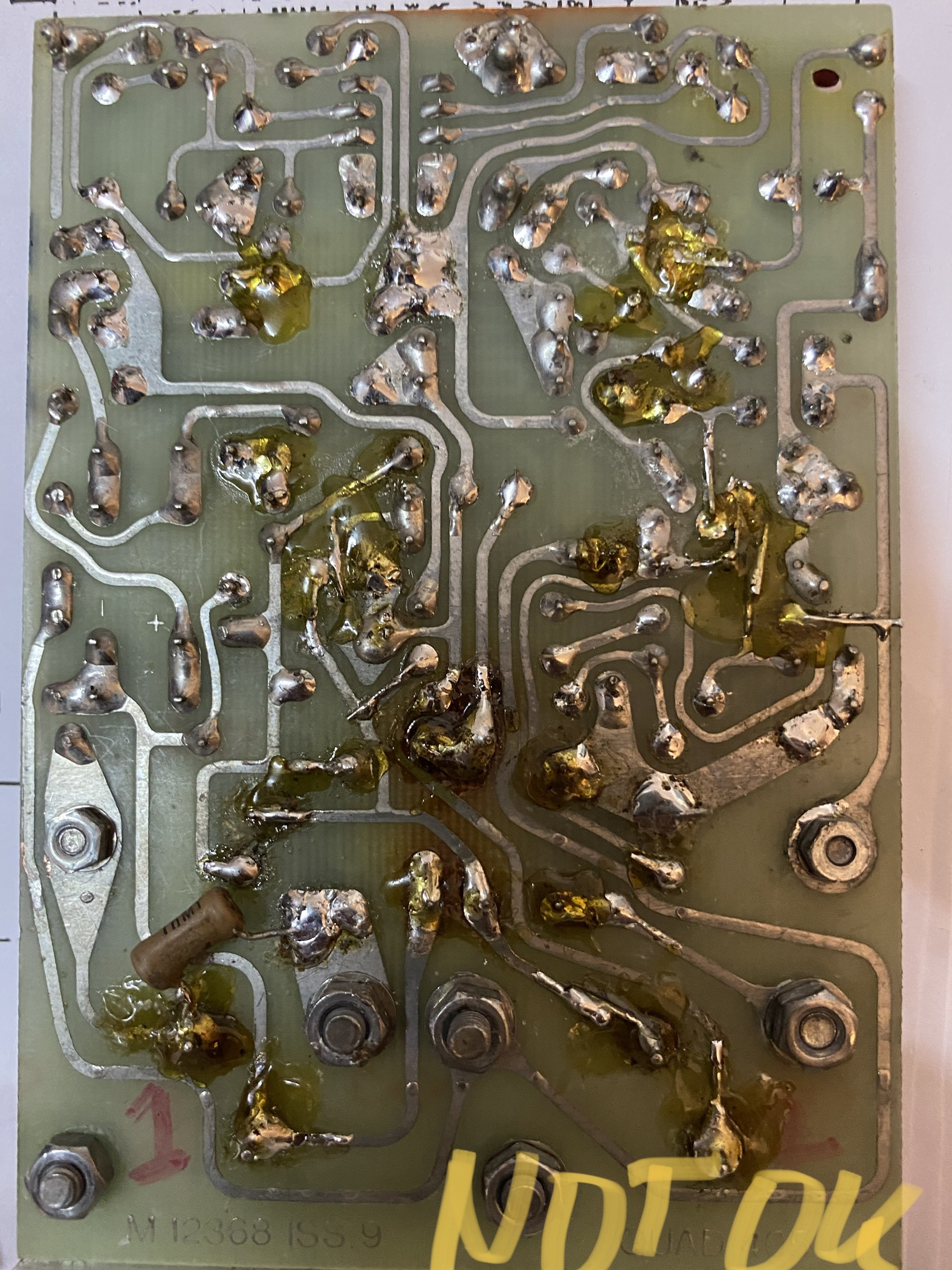

I am also attaching a photograph of the track side of the pcb
Regards
Assil

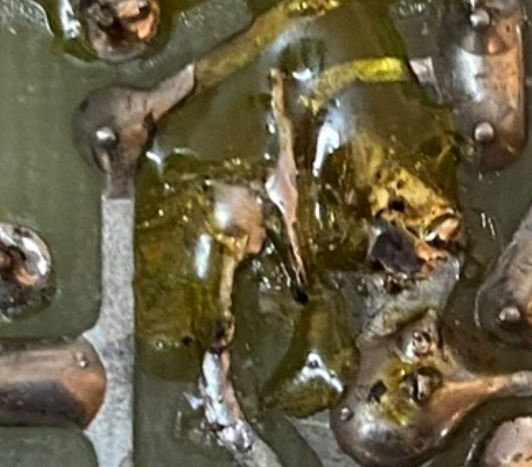

Hi Brian
It’s a Quad 405 which belonged to a person now deceased. It was out of service for around 18 years due to unsuccessful attempts by some technicians to repair. I received it with blown output transistors, leaky drivers etc . The Aforesaid technicians had also damaged some locations on the pcb. I had no other option that to use small links as you can find in the photos I sent earlier.
After checks and remplacement of components, one of the board played good while the other has a distorted sound even at very low volume. I have swapped components such as the inductors with another healthy Quad board. I replaced the diodes, transistors. I also swapped most of the ceramic /Styron capacitors
Problem still same
