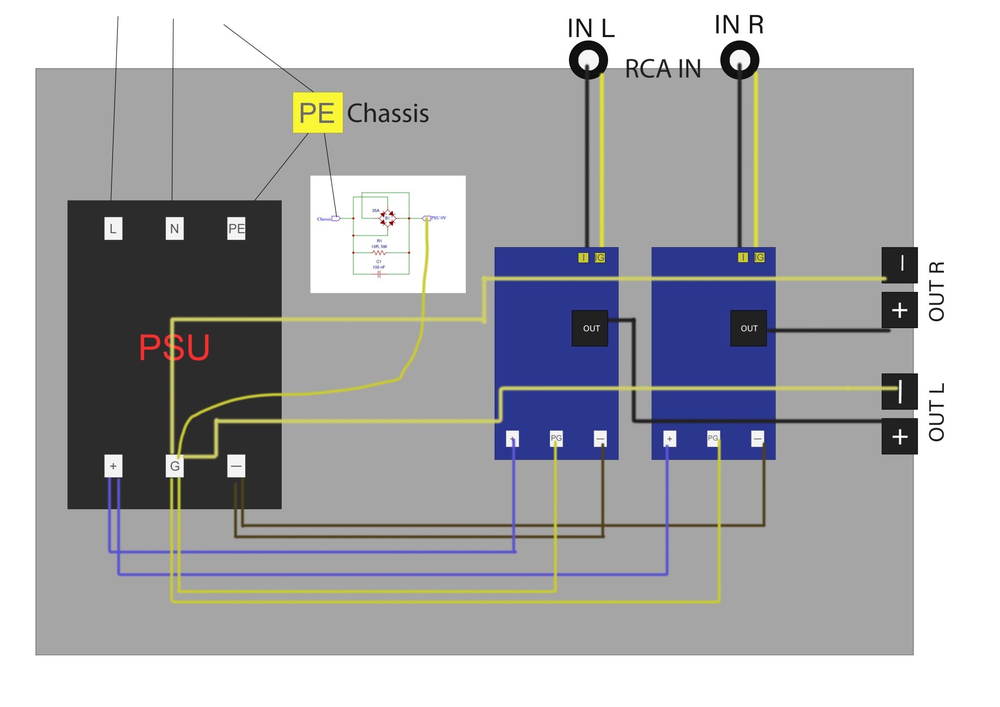

Hi everyone, I have 2 Quad 405 Clone boards which I would like to install in an aluminum housing.
I have wired the whole thing as shown in the picture,
but I can hear a quiet hum on one channel. It is not loud and you have to get very close to the woofer to hear it, but it is audible.
I use the following switching power supply, it is a +- 40V (I know it is not 50, I will upgrade it later).
I have also tried to remove the ground loop breaker and connect PE directly to the GND of the SMPS, same behavior.
I am quite a novice when it comes to amplifier construction, so please point out the mistake.
Many thanks for the great tip! It really has improved a lot, now it's just the position of the input cable, which means that when I move it, it gets louder or quieter, almost completely inaudible. And that's only on one channel, the other doesn't hum at all, no matter how I move the input cable. I have now screwed the housing shut, the hum is almost completely gone, but I have the feeling that I have forgotten to connect just one more little thing to make the hum disappear for good.

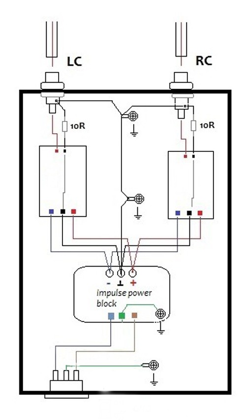

Hi..
Have you ever decided to solder 2x 10 Ohm resistors in ? Between the shield grounding RCA to the two amps. Is such a 10 ohm resistor on board ? I can't believe, its a China Clone....
The problem with rca may be that one rca ground becomes active and building out a potential difference if you use one supply for two boards.
Take a look to the picture...perhaps that way will help.
Greets
Peter
Greets
Peter
that diagram is showing a switchable chassis earth
chassis earth has to be a permanent connection
Hi...
Dont understand your writing....why remove the ground lift resistors ? I thought about to put them in...
Don't know if such resistors are on the board. Don't think so...
Greets
Peter

Basically, you build large ground loops when you place cinch sockets far apart.
It would be better to connect only one RCA socket to ground, and therefore run the earth signal via one RCA line only. This has further advantages: Diameters are reduced, which robs the signal less definition.
In most cases, the speaker return, the speaker ground, is best routed to the amplifiers first instead of to the psu. I would go by ear: what sounds better and/or hums less;-)

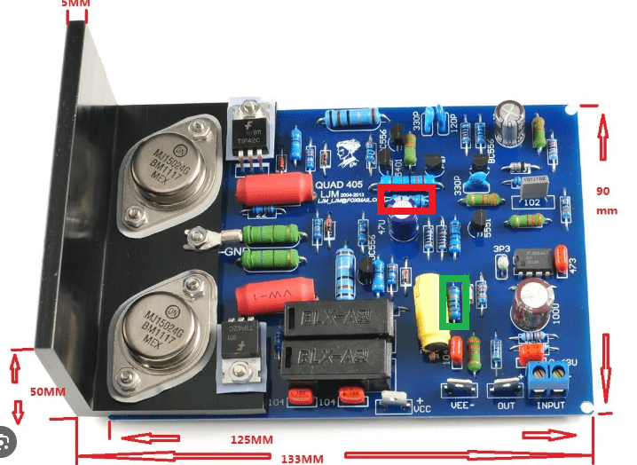

These boards already have a ground lift resistor as the original Quads do. It is the one in the red square on the photo. They are often 2R7 on these clones. Originally Quad used 10R.
Also check that the Zobel resistor (10 Ohm- green squared) is returned to the power ground on this board, and not the input ground. Some of the Chinese clones have this error.
Ok...
If there are ground lift resistors on board, forget about my idea. The better conclusion seems to be using only one ground from input to the the boards then...
Peter
Peter
Thanks, i'll check that now.These boards already have a ground lift resistor as the original Quads do. It is the one in the red square on the photo. They are often 2R7 on these clones. Originally Quad used 10R.
