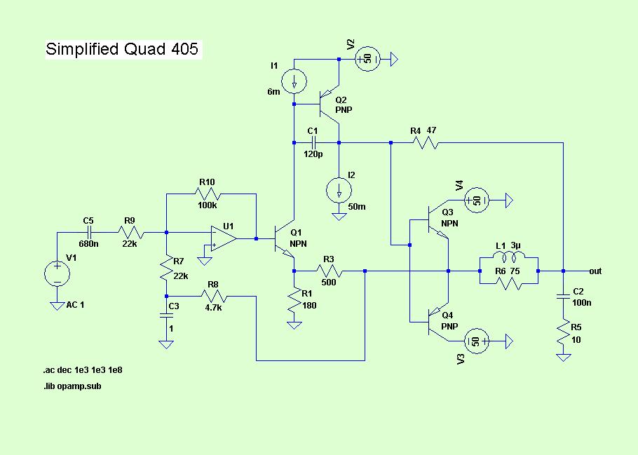

Schematic can be found here, into Jan Dupont pages:
http://www.audio-circuit.dk/images/schematics/Quad-405-pwr-sch.pdf
I would love to have the detailed circuit description ..including each transistor function, the audio patch map.

I have tried to simulate several times without good results.... so i think the circuit may be wrong or have some critical part... as i do not have knowledge about "how it operates"... i cannot fix it into the simulator, something i use to do in advance to the real world construction.

Now i see Cliff... unbiased output stage and signal during crossover cutting moments
provided by earlier stages that takes the job till 100 miliwatts.. after that the self biasing effect resulted from the audio signal will hold the job.
A resistance , a capacitor and an inductor (to allow more linearity across the audio band) connects an earlier stage directly into the output
Interesting.... very interesting.

Carlos,
I'm not sure what level of detail you need. Here's a very simplified schematic made with LT Spice. This should make the basic function much clearer.
The tricky thing with the simulation is that the "current dumping" transistors Q3 & Q4) are normally off. In a frequency domain simulation they will not play a role. So a time domain simulation is needed OR you need to add some artificial bias to the current dumpers.
Brian

Thank you Traderbahn... i'm needing detailed description
I have found other threads, and i have found current limiters and also voltage limiters.... this is not a very good idea but could not understand the reason why they have used those subcircuits.
Also i have visited sites where they update and upgrade the Quad 405 and other Quad models.
Well... i am studying the unit... and i have made some tests years ago, but had never good results.
Trying once again...of course your schematic is helping a lot too.
I would like to have a detailed description we use to read when factories explain how the circuit operates..... i have made an example into the first post.
