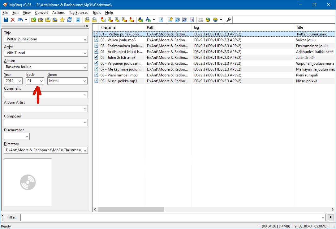

It's fairly straightforward.
An mp3 can contain optional data, including track number.
Download something like MP3Tag, and use that to edit that information. If you select an mp3, it shows you various details about it - just change it as you need. I attached a picture of it in mp3tag that shows what bit you want to change.
As I said - this is with mp3tag. No affiliation with it; just that I use it to do exactly what you are wanting to do, and it works. Other tag editors are of course available.
Edit: you'll see that I put the track number in as two digits: 01 to 09 on my example. This is so that they sort properly in the case of 10 or more tracks on there. So if you are likely to exceed 100 tracks, you'll want to use 001, 002, 003, ... , 099, 100, 101, ... .
Edit 2: And if you change any items in a file, dont forget to hit the "Save" button for that file before you move onto the next. (Blue disk icon at top left.)

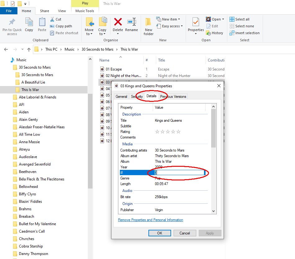

Windows has been able to do that since at least as far back as 7, FWIW 😉
