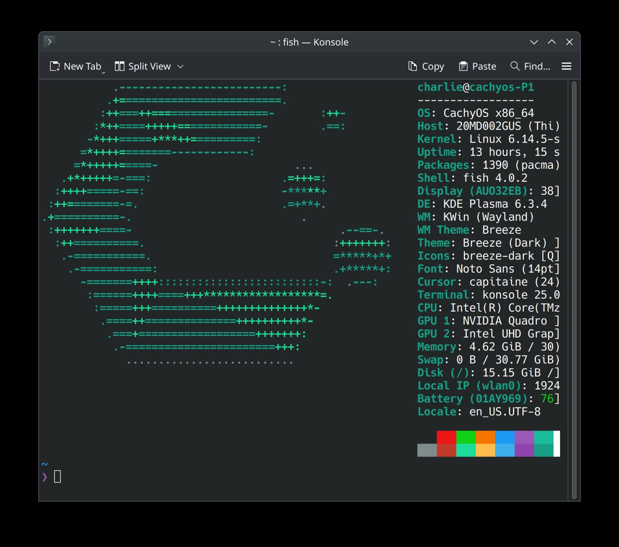

Harware and software details of this CachyOS installion on this notebook:

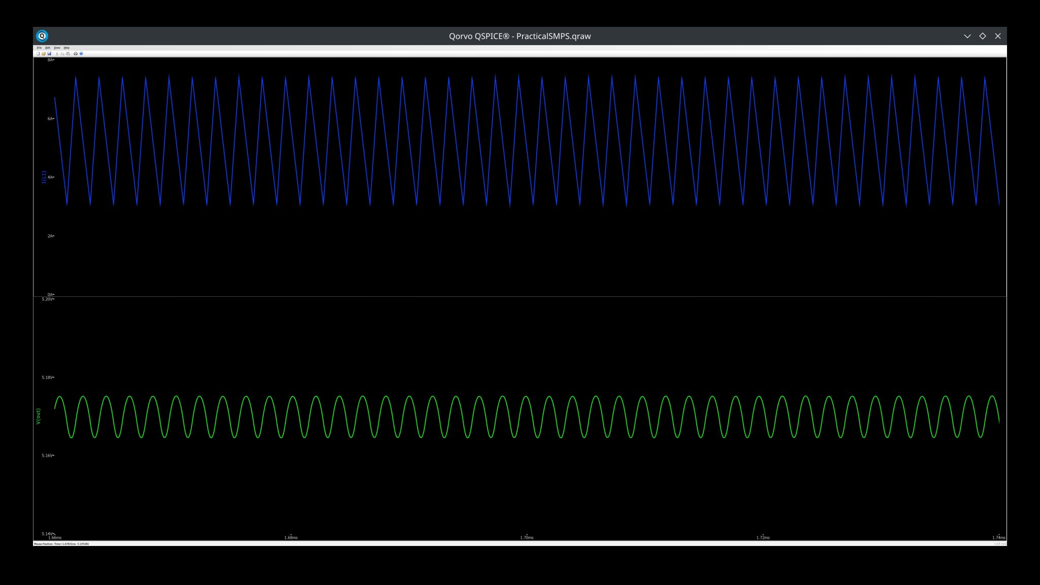

Smooth graphics:

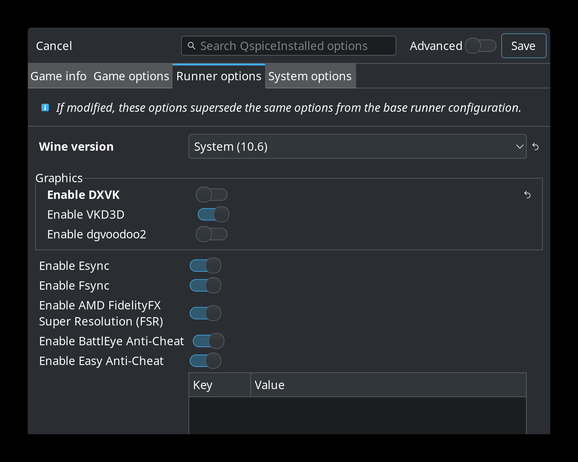

I have attachments below that clarify the important points of how to configure Lutris for QSpice. The big picture is to select Wine as the runner, and to deselect DXVK and make sure you enable VKD3D. I deselected DXVK because I know that Mike is using DirectX 12 calls and not DirectX 11, 10 or 9.
Next, under runner options, the default runner for Wine, which is the latest, did not work. Close but no cigar. The one I had to choose was the
System(10.6)
. No other option worked at this time.That's it!

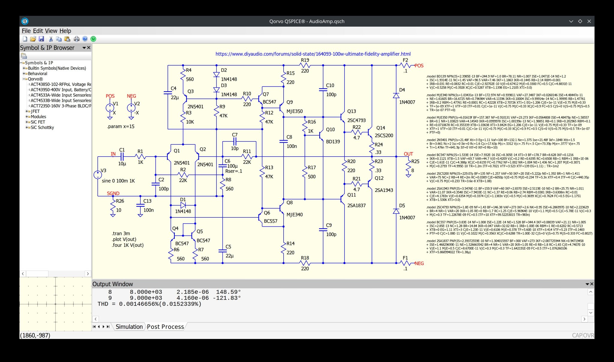

Seeing is believing:
Smooth graphics:
Runner options panel, details within Lutris setup:
