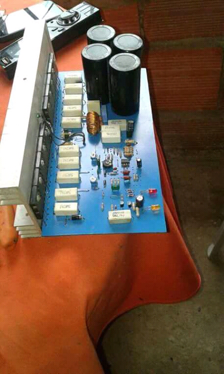

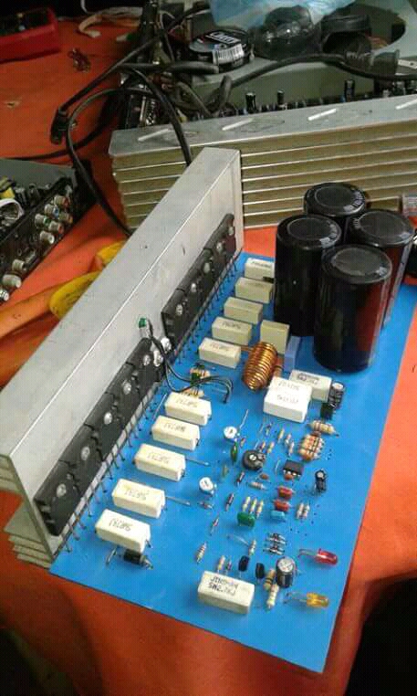

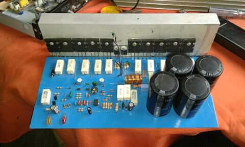

Hi guys. Several months ago, I uploaded a homemade amplifier based on RMX1450 of QSC. The sound is very delightful and I tried to build the PCB as compact as possible with discrete components. I followed the diagram carefully so it work fine 100%.

QSC power supplies float at the speaker voltage, so each channel has to have it's own power supply.
Another advantage is that the drivers need only drive enough voltage to drive the BE input of the output transistors. This suits op-amp based circuits.
Crown took the idea another step by combining this with a bridged pair riding the moving rails, so you get a bridged amp that you can bridge again to get 4x the supply peak voltage.
That was in the 70s, 80s because I moved to computers in 86, so I dunno what happened with amps later. I do know that the professionals now sell ~5KW amps, variations on Class-D, I suspect. Later, I did use a couple UDCO shaker table amps, a cyclotron and a IGBT class-D (~30KW, 60KW 480VAC 3 phase).
It looks like QSC no longer has Service manuals on line, just user manuals. But I found some old schematics else where and I note that this one uses Collector facing outputs, which meant that all the power transistor Collectors were grounded and therefore did not need sil-pads to isolate them, making for better heat transfer.
I think they did pull all of their old schematics - I downloaded most of them over the years and the rest would be so similar that I’ve got a good starting point. Don’t know much about their new class D stuff - if it is like everyone else’s they would be very closely bases on IR’s reference designs.
The only thing non DIY-friendly about their old classic designs is the fact that they require independent isolated supplies for each channel. You either spend 80% more (and 80% more weight) having two transformers, or spend 300% more getting one custom wound. Or you have to wind your own, which not everyone can or should do. For a single channel for a powered sub it’s a non issue, but to fully clone an RMX1450 takes a little more work (or expense) than your average DIY amp.
