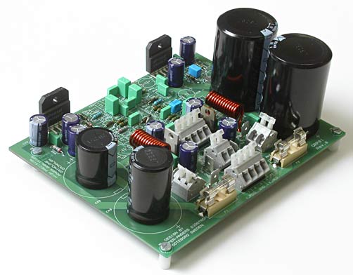

My monster is coming alive......
I start with AD8620 as buffer and will also test big caps vs. small caps. The little one is 1200 uF, the next is 2200 uF and the big mama is 10000 uF. All types are ELNA LP3J.
The inductor is only for the picture. The size and the need for it isn't investigated yet.
The left side is non-inverting buffer and non-inverting LM3886 and the right side is inverting buffer and inverting LM3886

tiroth and two more people are building prototypes. I'm also going to get my working eventually.
Note also that I use Wago connectors which are unique, Noone has used those before. The effect is similar as peeling the capacitor covers off. 😎

The less is more philosophy is very much possible, even for my pcb! I have made an option for it. Just check model 5 and model 6.matjans said:lyou're using pcb's and it looks pretty complex. There goes the 'less is more' philosophy..

It actually isn't complex unless you want it to be. I like it because it gives you a structured "playground" to try different configurations, including filters, etc. And since it has 2 channels, you can compare (as shown, with one inverting , one NI)

The monster is alive. Seems to work very nicely so far without heatsink. Output offset 115 uV, Left channel, 10 uV!! Right channel. I haven't put through music yet but the weekend is saved 😀
The first time I tested I forgot to solder a couple of wire jumpers = some current = hot. The LM3886 didn't go
