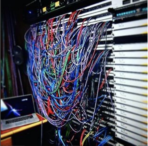

Interesting and I’ve wondered about this too, but I haven’t personally stressed out about it much beyond using Neutrik / Amphenol connectors and Mogami / Canare cables wherever possible in my own studio. Most music made outside of bedroom studios is running many tracks through lots of outboard equipment and likely using patch bays for a lot of it.
