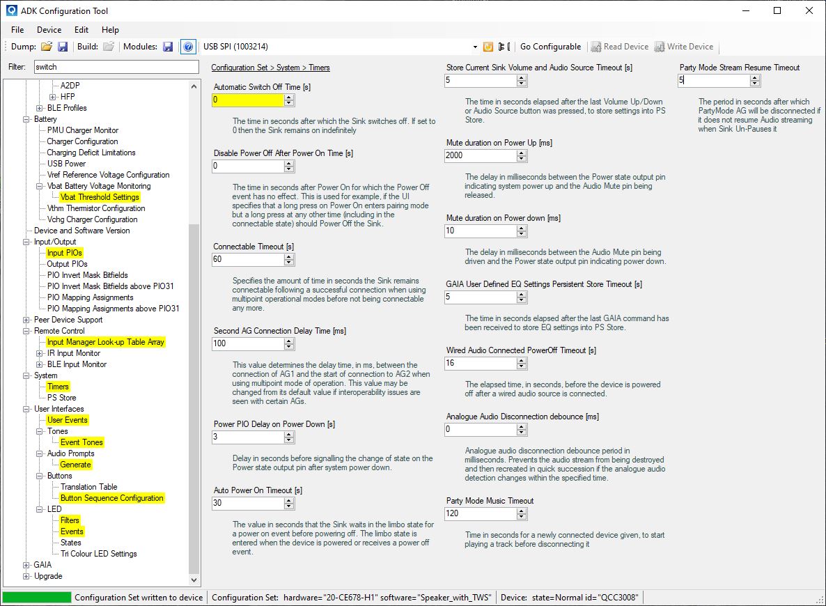

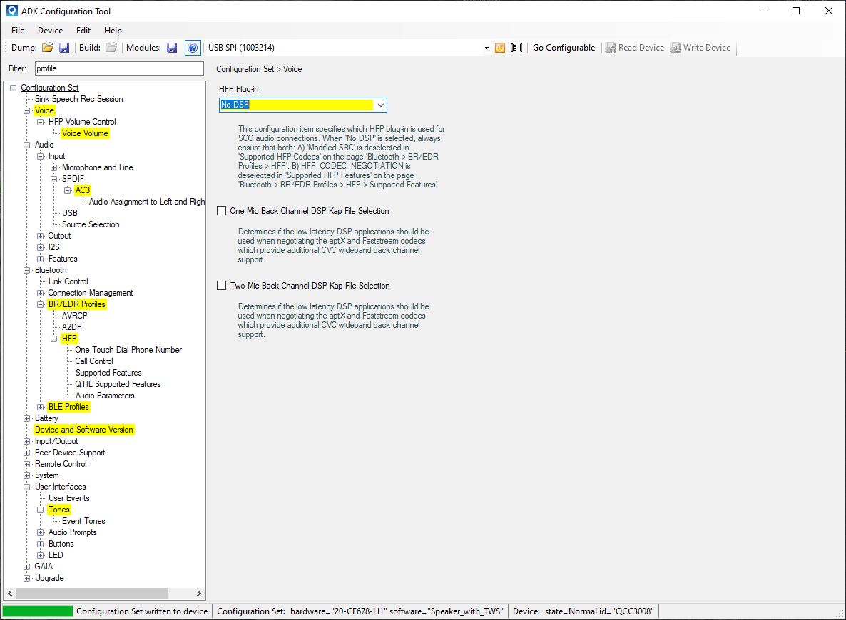

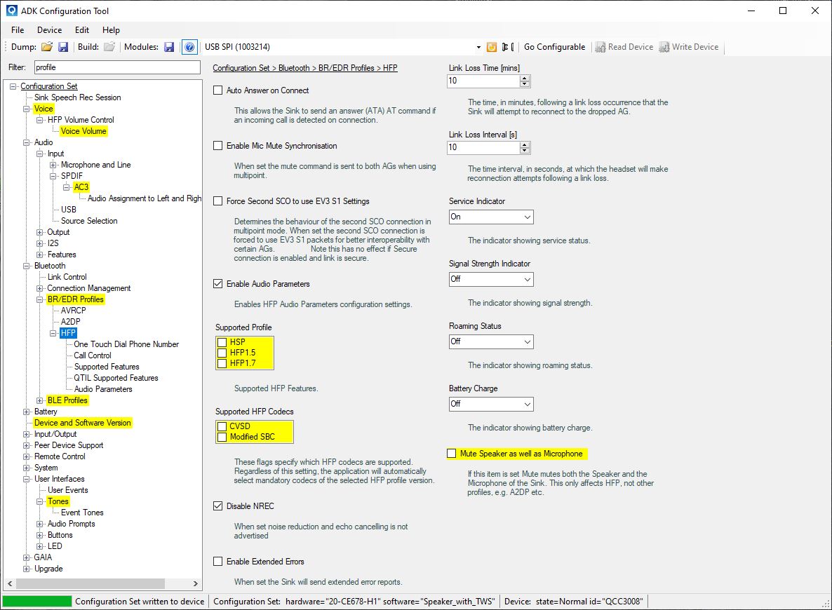

I've checked and I did have HFP Plug-in set to hands free and 1 mic, but changing this to 'No DSP' had no effect.
Unchecking all 'supported profiles', HSP, HFP1.5 and HFP1.7 had no effect.

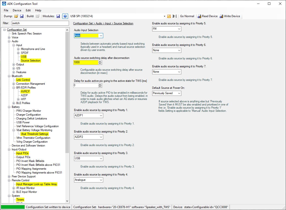

Messing with AVRCP audio switching also had no effect - the description of one of them makes it sound like it will be ready faster if checked.
Attached are a few screenshots of some pages in the config tool.
I have previously played about in the timers section a lot to try and fix this, but I can't remember what I have tried, only that nothing worked.

Yes. It seems when there is no audio, the pin is at 0V. Once I play audio, after approximately 1 second, it is pulled to 1.8V. After about 4 seconds without audio, it falls to 0V again.
I suppose it might be possible to pull this high to force it to never mute, if we can't find the solution in software. I've been playing in the config tool again (searching for mute), but I still can't find anything that had an effect on this.
