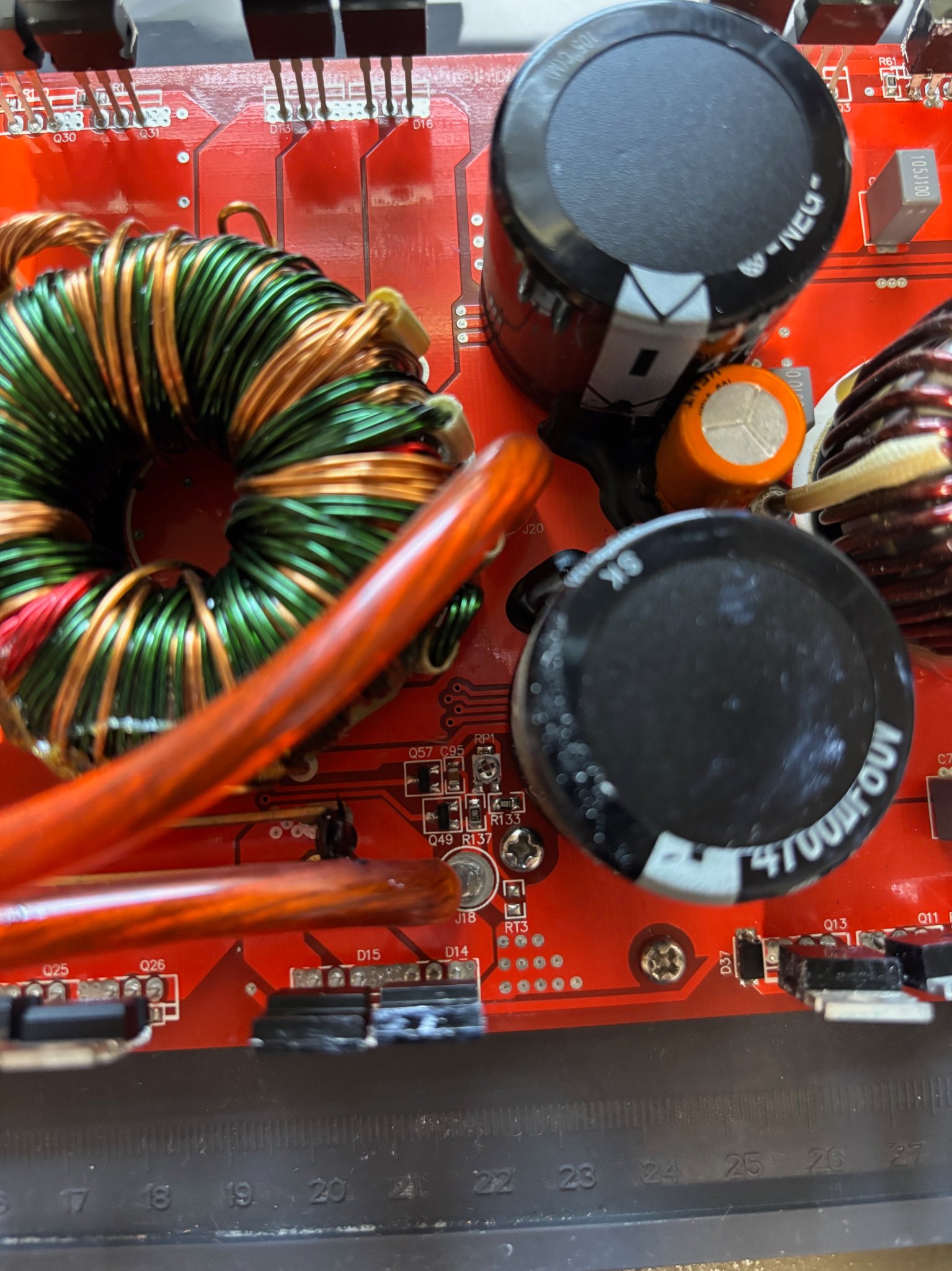

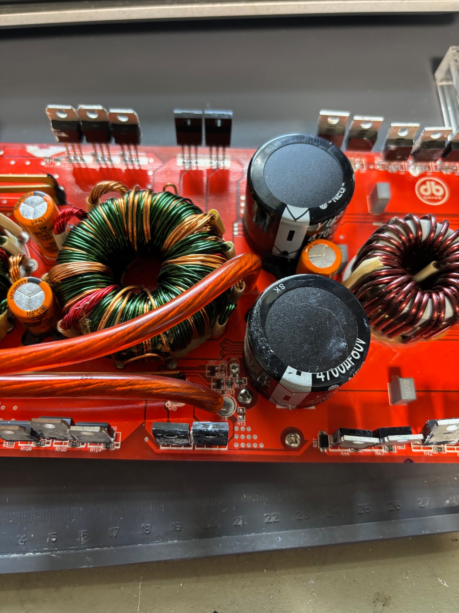

Hi everyone, Anyone know what the part number is for these bad boys? The marking is 2L(Q49) NEXT TO R137 on it and it doesn't want to play with me anymore. Mr Perry hooked me up P/N is 2N5401
