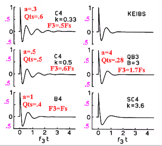

However just to give you an idea, here is the step response for certain vented alignments, taken from Richard Small's, (of Thiele-Small fame) article.
Please note that a=Vas/Vb. So a speaker with a Vas of 2.0 cu ft, when put into a box of 0.5 cu ft, will have an a=4. Generally, you will see the larger the a facotr, (that is, the smaller the box compared to Vas), the tighter the bass.

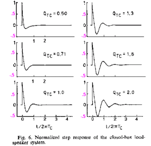

And now here is the step response for closed boxes with various Qtc's. As you can see, the difference between a Qtc of 0.5 and a Qtc of 1.0 is much less than the difference between Qtc = 1.0 and just about any vented boxes, even the smoother ones.
So if you enjoy vented boxes, as I do, you will hve no trouble with a closed box of Qtc=1.0.
