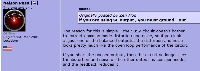

Bill Fuss said:
... why it would be beneficial to AC short the unused output to ground.
This will also help.
Bill Fuss said:
I was wondering about that post from NP also. I started searching threads to no avail and got sidetracked. I think that post was from an X preamp discussion. Someone please enlighten us.
Bill
almost SUSY , but not completelly - due to common source degeneration of input differential ;
if you decrease R51 and R66 to few ohms ( up to 10 ) , connect just one - lower - CCS ( with doubled current comparing to previous situation ) to middle point between them ( off course - deleting trimpot ....... ) , you'll have fully functional SUSY center of universe 😉
then - just set adequate gain of circ with values of R48/R5 and R63/R6 - for left and right side , respectively
