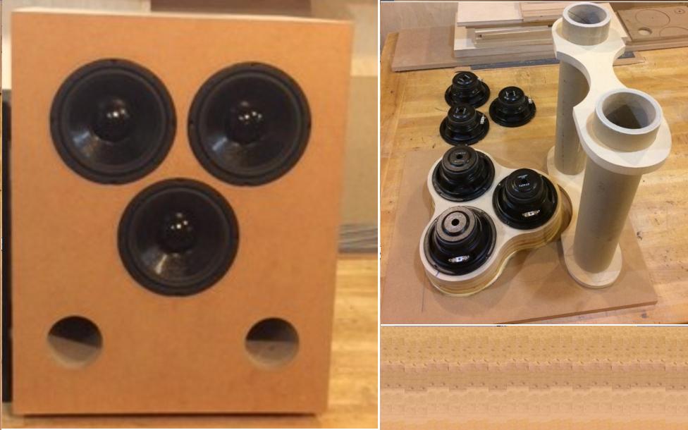

But wait, this is better, thinking about taking my speaker wheel. Started off as a HT sub, but gave up and moved on to something better. Then realized getting some really nice "live music" sounds out of it. I'll add it for reinforcement on the low end with a separate plate amp.
