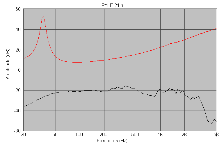

As provided by Magnetar:
Pyle PDW 21250
FS - 31.61
RE - 5.59
RES- 59.81
QMS- 4.03
QES- 0.38
QTS- 0.34
L1- 1.88
VAS - 274.29 liters
SPL - 95.4
Pyle PDW 21250
FS - 31.61
RE - 5.59
RES- 59.81
QMS- 4.03
QES- 0.38
QTS- 0.34
L1- 1.88
VAS - 274.29 liters
SPL - 95.4

I own a pair. I really like them. Well made cast frame, very high build quality. Magnet is huge, very heavy speakers. I use them at home and definitely they are not used to full potential. I don't know how they'd perform when driven hard at a night club or at a concert.
looks like t/s parameters differ with each production run. you need to buy drivers first, then design cabinets for them.
Measured on 24x24in baffle standing on hardwood floor.
I don't remember mic distance, maybe ~12in.
Is it likely the linear Xmax is very low? Like 1-2mm each way. There is a Monacor 18" unit like this:
http://www.monacor.de/typo3/index.php?id=84&L=1&artid=3569&spr=EN&typ=full
At this Sd it'd still probably have good output and within the limit sound great, but max SPL won't be as much as you might expect.

I have one left, other one had a cold solder joint problem. Took a look @ the coil overhang awhile ago, with my pen laser and estimate 10mm Xmax. Originally burned it in with a 1200 wrms amp just below clip @ 20 Hz for a 8 hrs, it didn't hit the backplate and I estimate about 1 1/2" p-p mechanical limit.
I would put up a hornresp sheet for a tapped sim if I knew how to. Seems like a good unit. 129 dB(+1-2) from 33-94 Hz in 430 litres.
