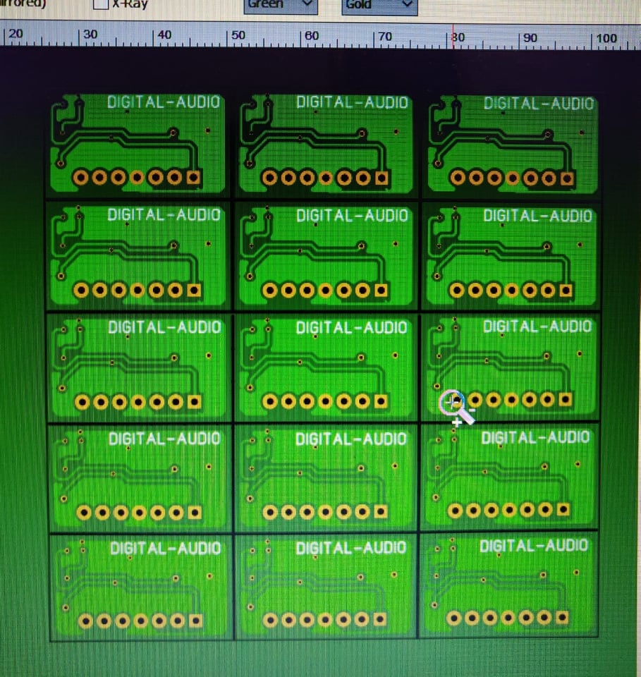

PWM TD CLASS

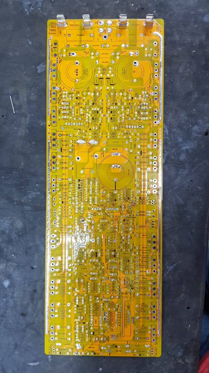

I am also making TD class stripped orignal pcb to clone pcb😉😉😉

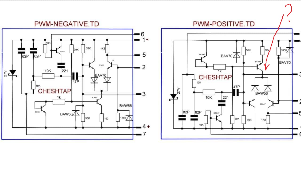

BAV56 не правильный знак

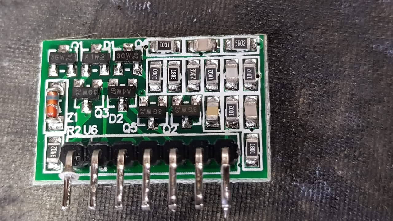

Hello,PWM TD CLASS
Sir i have an Martin Audio MA6.8Q and one channel is clipping at very low volume, i saw a board called PWMPATD-f01 seems to been hot because the glue over it is grey. cand you tell me if your schematic is good for my amp ?
