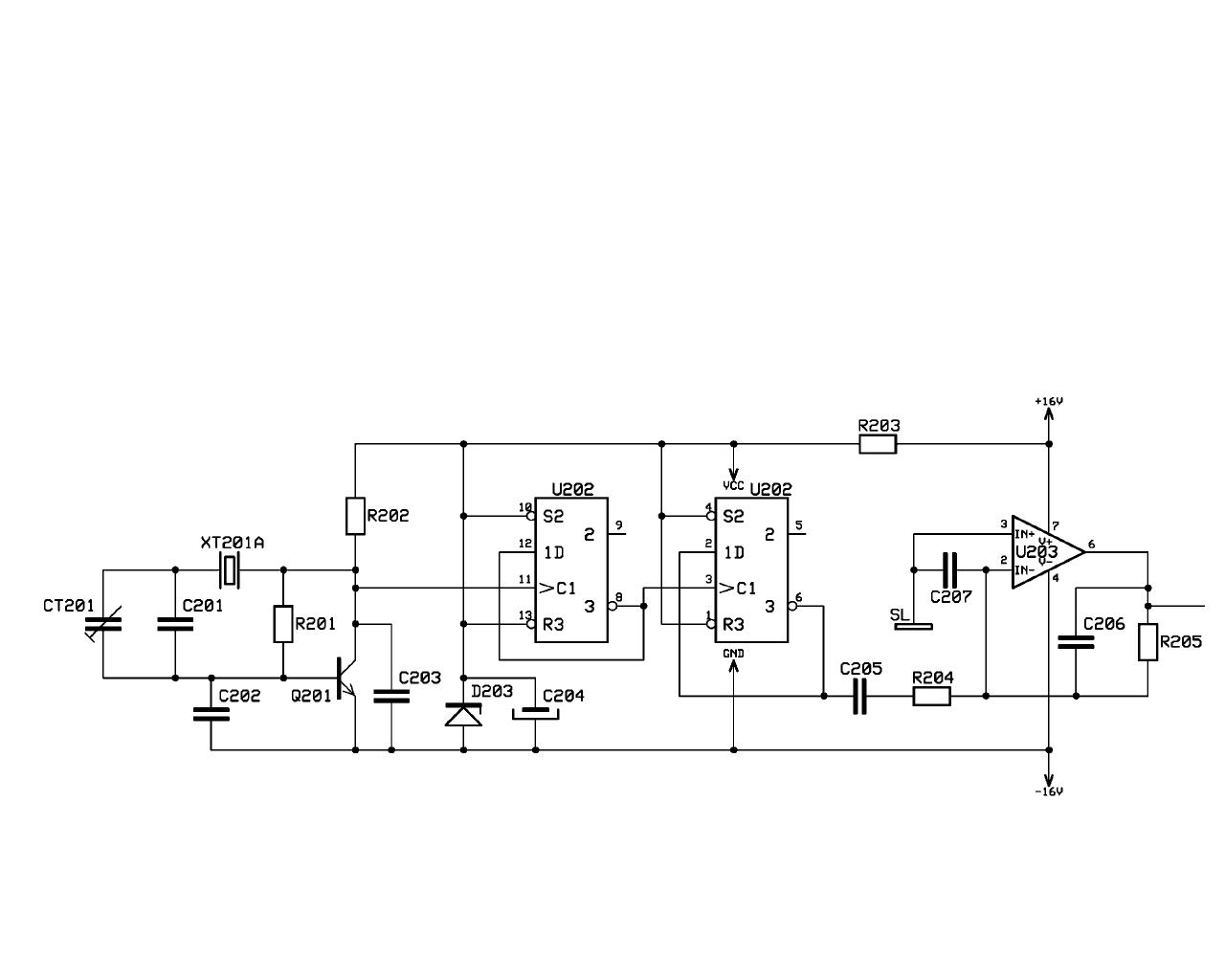

hi friends, I build my first amp class d. and as a basis I will use ir2010 with irf640, so I'm in doubt on some points:
I use self-oscillating modulator or PWM modulator with comparator or sigma-delta modulator?
I'm having trouble getting a perfect triangle wave in PWM module to use. I am using Orcad 16.3
I look for something more complete for I will ride with a dc-dc source and use in the car but do not want anything smd, I will not focus on the size.
What you tell me friends?

you could use 4060 with xtal and use one of 4060's output, run it via RC to get a perfect triangle wave, but amp will be clocked. Few guys before me used this, I tried and works great and it is always stabile
LabGrupen use this triangle oscilator for class TD, with 74HC74 and LM318 frequency is over 600kHz.
In thread http://www.diyaudio.com/forums/class-d/182900-class-d-amp-lm566-lm393-2xirf530-4.html post #39 you can find FBT schematic (250kHz)

I've been doing some simulations in Orcad, but it did not anything right, because I think the model IR2010 spice I need not work in version of ORCAD I have, I will test these circuits that you guys passed me and then pass the results. I need to find a similar program that has the IR2010 in the library, because with budgeted will not leave anything.
