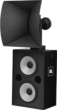

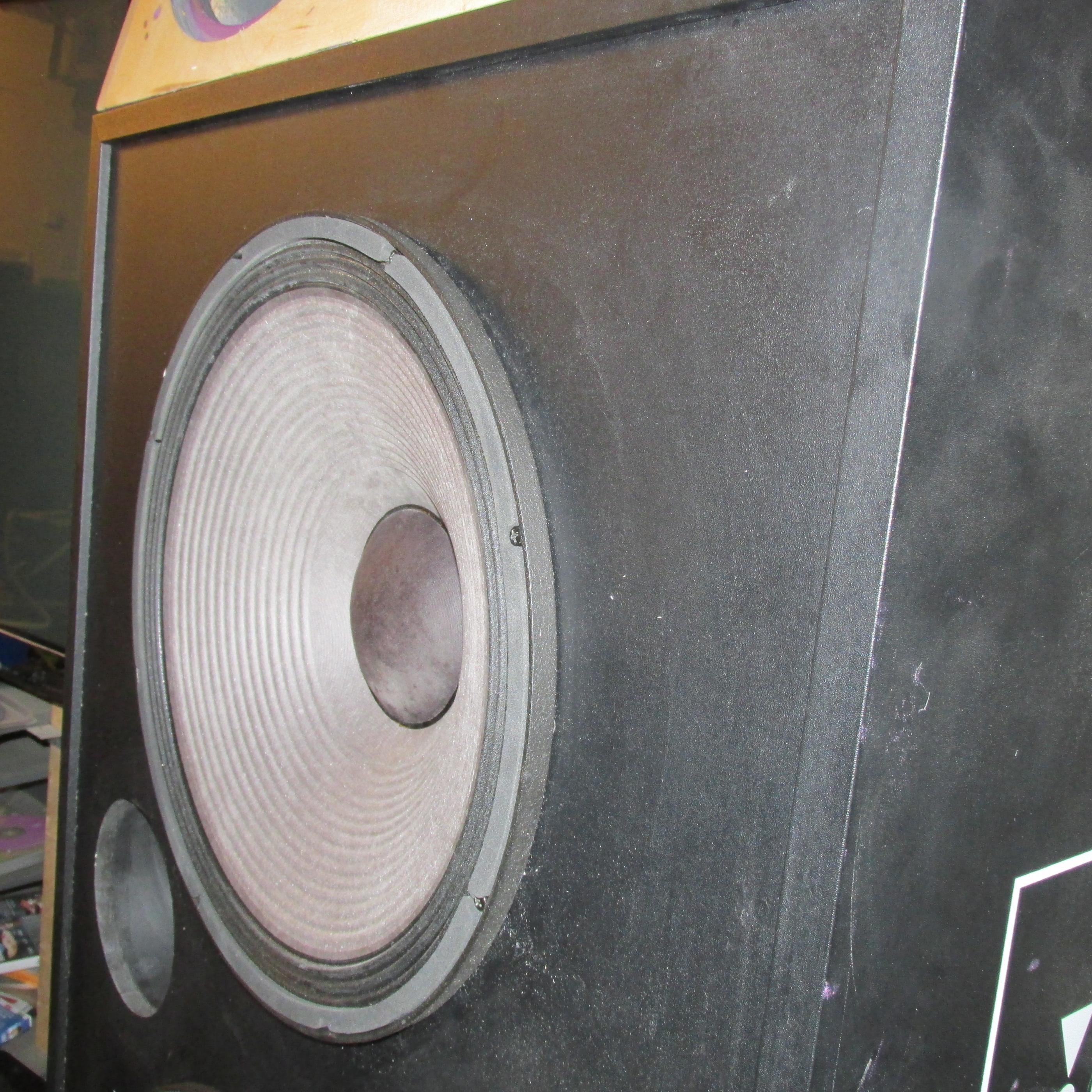

trying to work with this cabinet at present JBL 4638 twin 15" JBL_4675C_503cd5f489b62.png
now I have a couple of previous posts regards this. (jbl 4435 knock off)
But what i am looking into is, as i have the cabinet vertically unlike horizontally (jbl 4435)
lower driver crossed around from 20---300hz
next driver 20---1500hhz plus
there is a 600hz null with this cabinet center-center spacing.
the waveguides I have are the jbl/pyle 612 econowave now previous advice was that waveguide could not go low enough.
so i had a brainfart🙄

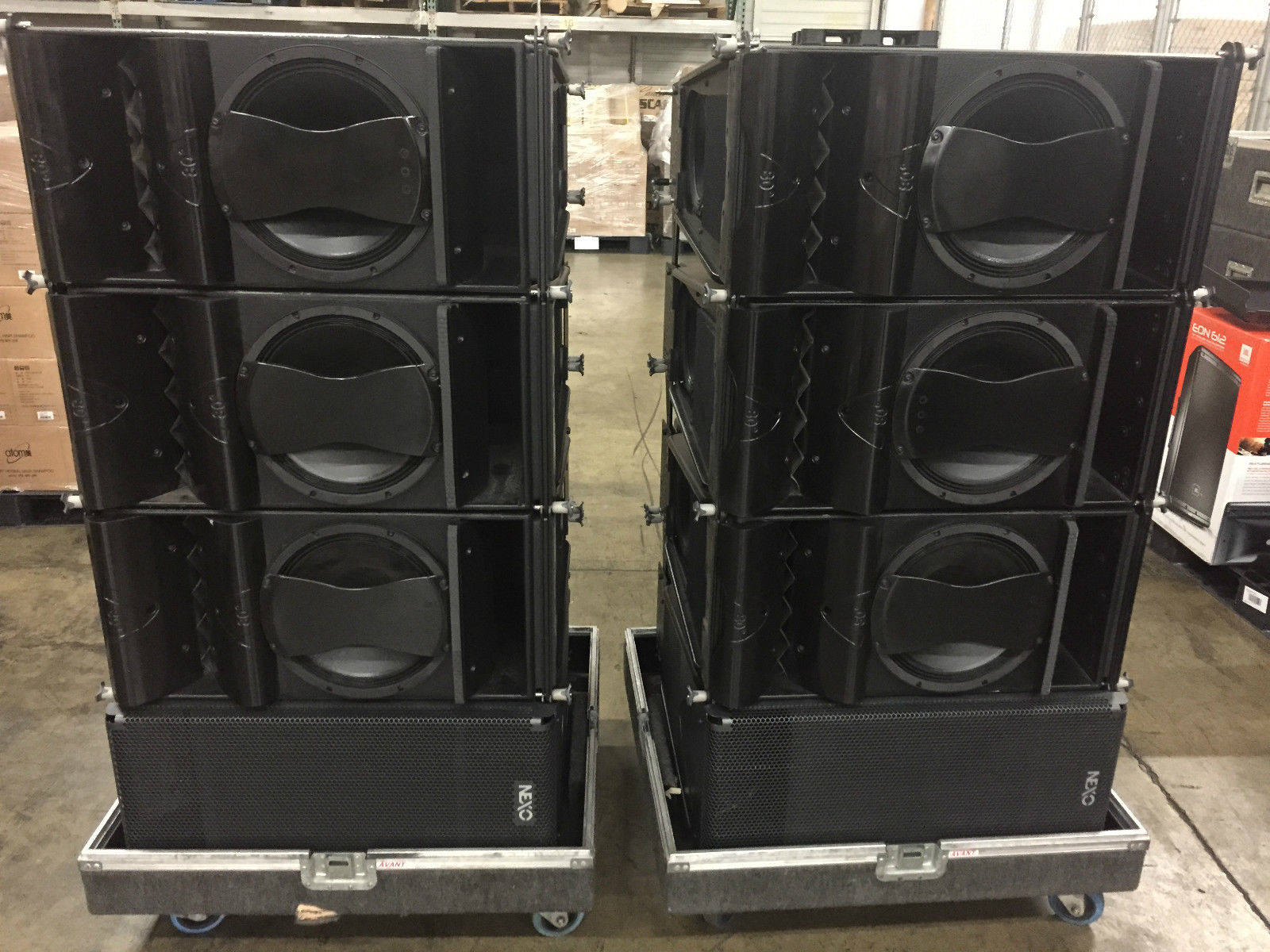

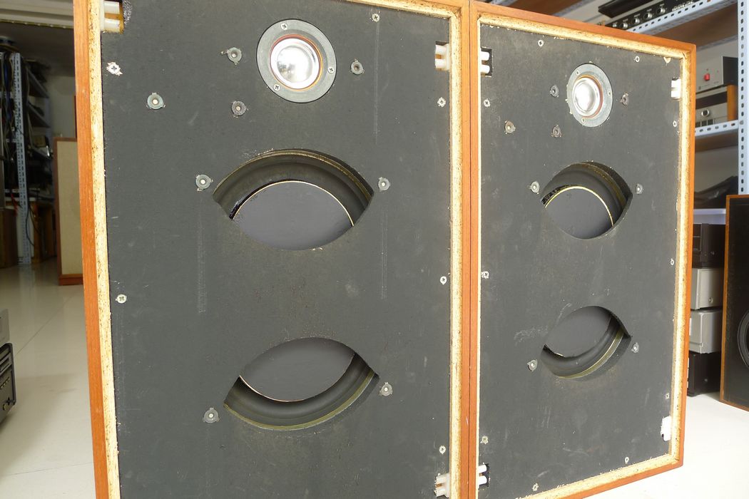

here is some drawings of what i was thinking (DSP INVOLVED REGARDS DELAY XOVER)
basicly having the compression driver and waveguide mounted on the driver but protuding quite a bit forward from the baffle.
if i have not put it into words right please say
jbl 2035hpl
the two 15" DRIVERS ARE jbl2035hpl
I can't find any frequency response graphs for these online, sent a request to JBL but no response from them.
a poster on audio heritage said they are good up to 1200hz

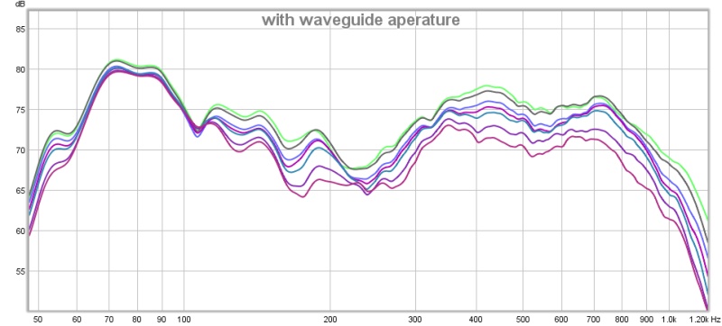

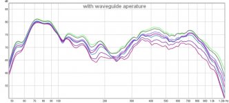

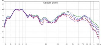

well after a few measurements here is where i am at
made a nexo directivity guide
all measurents raw no eq or crossover
measured on axis then 20/30/40/50/60/70 degrees without guide
and here with the guide

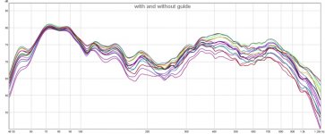

will have to measure verticaly next (cabinet laid)
But I could here a distinct difference verticaly between top driver and CD waveguide mounted on top of cabinet
Raw measurements line up with impedance, so need to find out what's causing all the HF 'ripple': Home Theater Overhaul: JBL Pro L/C/R Build
Reflections off the frame, cone breakup or........? Otherwise not sure how well a simple phase plug will help.

here is a photo of the cabinet, drivers are not flush mounted, but are 15mm from baffle proud
sides protude about 8mm infront of baffle
I can router the sides flush and recess the drivers into the baffle?????

The HF peaks in the impedance plot.
GM
Hi GM I am a lttle confused as what you are refering too?
I have not posted any impedence plots just response graphs.
please forgive me,
if you are refering to the graphs I posted, then at what frequeny do you call (HF)
or is it the link you provided that you are refering too.
many thanks
Greets!
The ones in the link I posted.
'HF' in the sense that it's the upper BW of the woofer and in particular, the BW above the driver's upper mass corner where the cab's impact on the driver's performance has faded away [Fhm = ~2*Fs/Qts], so only the driver's forward radiation.
