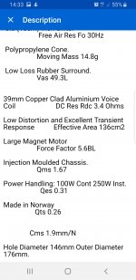

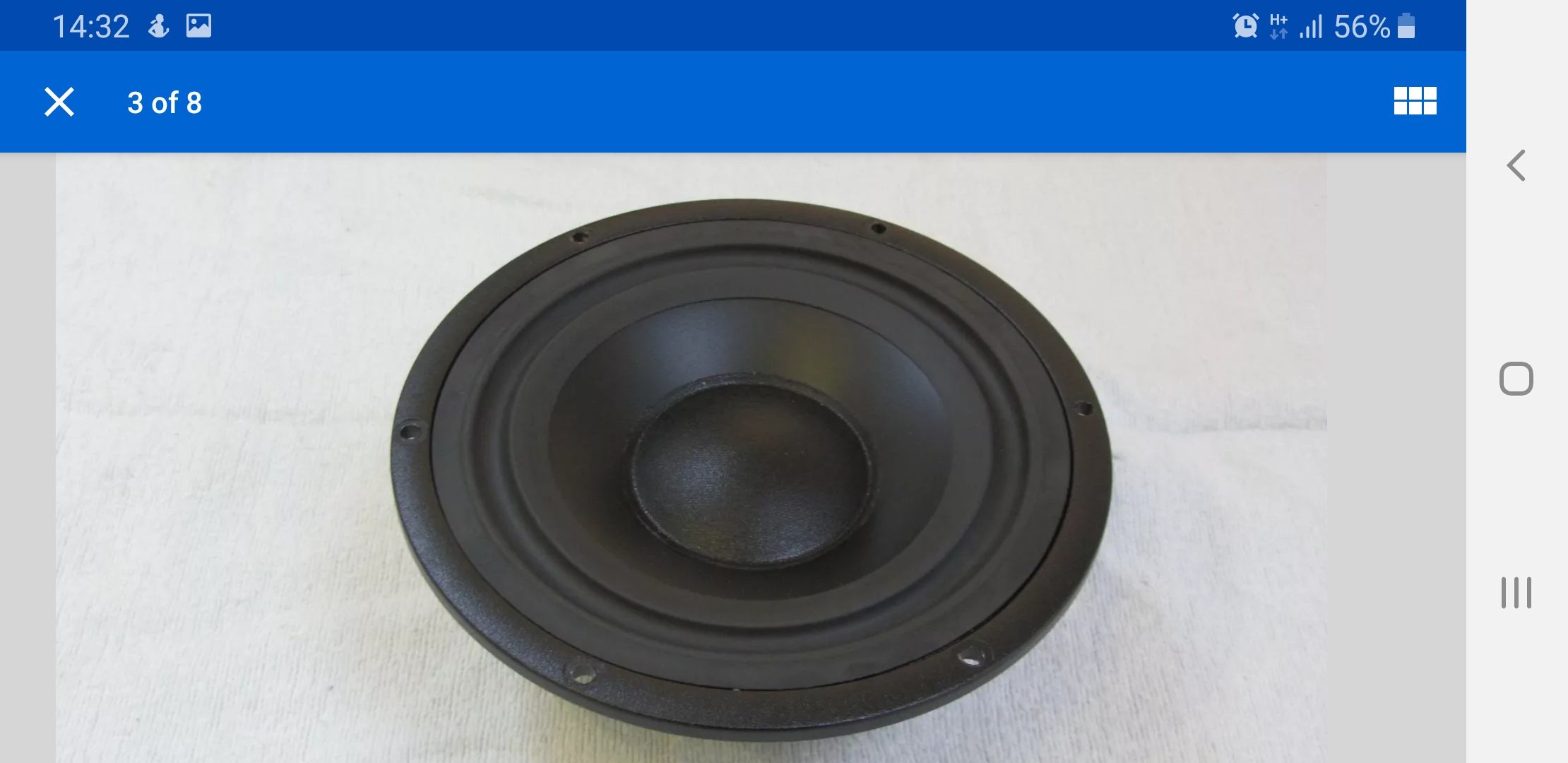

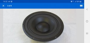

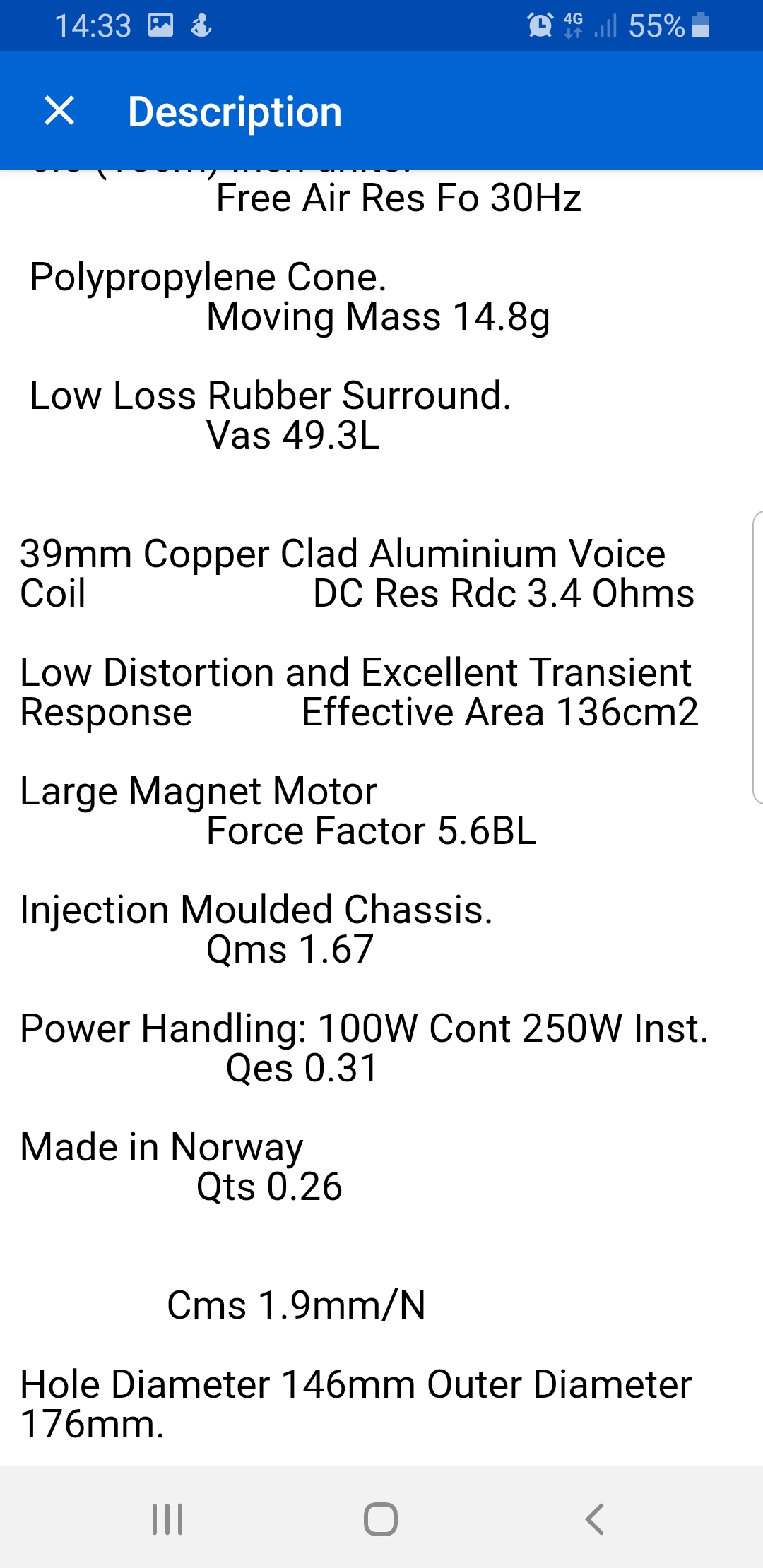

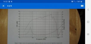

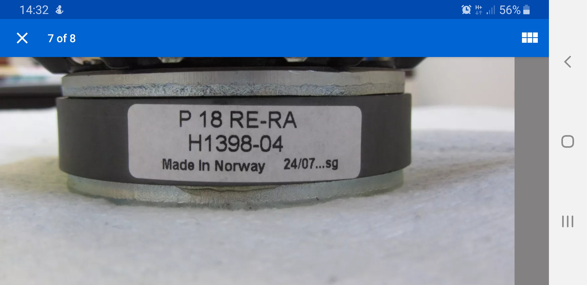

Thanks for the input Dave. They are proprietary OEM drivers made by Seas for some speaker company that folded many moons ago. Shame. But they were cheap and so I grabbed 4 of them.
My baffle width would be 250mm wide. Maybe I'd use that little peak and dip 400 to 500Hz as an XO starting point.? Manufactures FR graphs obviously, I havent measured them myself

You have more info than i did with the 20 similar drivers i scored made for PSB.
250 mm implies an approximate BS(-3) of 460 Hz, which by itself suggest an XO between 325 Hz and 460 Hz (i tend towards the lower number). The bipole dip is related to the difference between the distanc of the front driver & the back driver. Half the width plus the depth of the box are used to figure out exactly where the dip comes.
I’ll have a look at the drivers.
