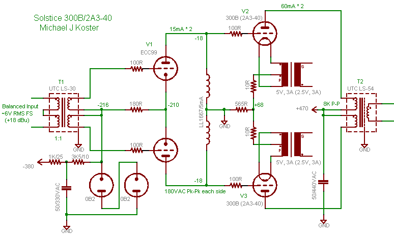

This is actually a good application for a plate choke, because the DC current can be balanced and the choke can be on the order of 300H. This works really well with triodes having 2K or less plate resistance (ECC99, 5687, 7119, D3A, 5842, 6C45pi).
Low frequency performance is outstanding, corner frequency of something like 2-3 Hz, which means that distortion at 20Hz is not starting to increase much yet due to finite inductance. Each tube sees 17K ohms inductive reactance at 20 Hz for 270H total inductance.
High frequency performance is excellent, with the driver going out well past 50 HKz.
This performance is in part due to the high quality of the Lundahl LL1667 choke.

My current project amp requires around 200Vrms to drive the output stage into clipping. I am currently using CCS plate loads for the driver with ~800V B+. I'm getting more than 1% second harmonic at 1W due to the fact that a differential stage with CCS plate loads is hard to balance AC-wise.
I was thinking maybe a plate choke where the two sides are coupled together might help balance this out, but I can't think of a way to make this work well. A tube capable of putting 200Vrms into 17k (with comparable distortion to what my 6SN7s are putting out now) would be monstrous and probably doesn't exist, plus it looks like gain would vary quite a bit with frequency due to changing load impedance. I think I am gravitating towards an adjustable first stage(differential) load imbalance (a pot) even though I would love to have the circuitry be self-balancing.
This is actually a good application for a plate choke, because the DC current can be balanced and the choke can be on the order of 300H. This works really well with triodes having 2K or less plate resistance (ECC99, 5687, 7119, D3A, 5842, 6C45pi)...
Wow, I like it! I like how you used the negative supply so that you don't have any dangerously high voltages around. But the input needs to be blocked from DC, right? That's why the input transformer...
That amp's a lot like a two-stage, DC-coupled, push-pull 2A3 amp I built. It's my current favorite, but only makes 6 watts class A each side. I was thinking of making another one but with 300B outputs.
My amp has the output stage power supply "stacked" on top of the driver stage power supply (say if the driver stage is +200V, then the output stage 'ground' is referenced to that, so floats at +200V). I think the output stage B+ is about +300V from the 2A3 plates to floating ground, so the whole stack has a total of +500VDC to earth ground. It would be quite a bit higher than that if 300Bs are used. Driver is a 6H30Pi long-tailed pair with an unidentified PP OPT (designed for PP 6BQ5) as the PP plate load. There's a -30V supply to feed the tail of the 6H30Pi. I think there's a 4kohm resistor in the tail, which should definitely be made larger in value. Perhaps an LM317T or some kind of FET as a CCS...
A voltage does not become less dangerous because it's negative. All that's done here is to transfer the danger to the input transformer and cathode instead of the plate and plate choke. Careful!
In this configuration, you'll also have to bias the heater supply to -150V or so in order not to abuse the heater-to-cathode voltage rating.

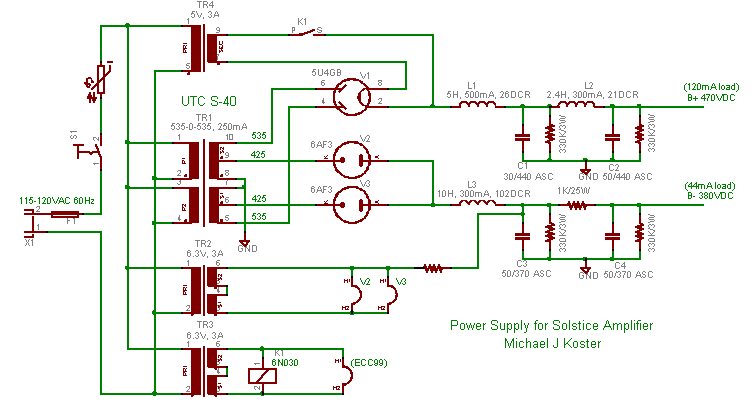

This is true. The 2 supplies are still stacked, but ground is in the center. So the B+ is 470V above ground and the driver B- is 380V below ground, for a total voltage difference of 850V. The same amp could be built with stacked supplies, eliminating the input transformer, and you would have +850 from chassis to B+. In this amp, the 850V differential appears across a few inch space in the power supply, and between the driver and output tube sockets. It's not much of a safety issue for me because I don't probe around in a live chassis.
Do you think it's dangerous to have -300V on the secondary of the input transformer?
I raise the driver heater about 50V off it's cathode using a voltage divider from regulated B- to ground, not shown on the schematic. A UTC S-40 has all the windings needed (except of course the DHT filaments).
