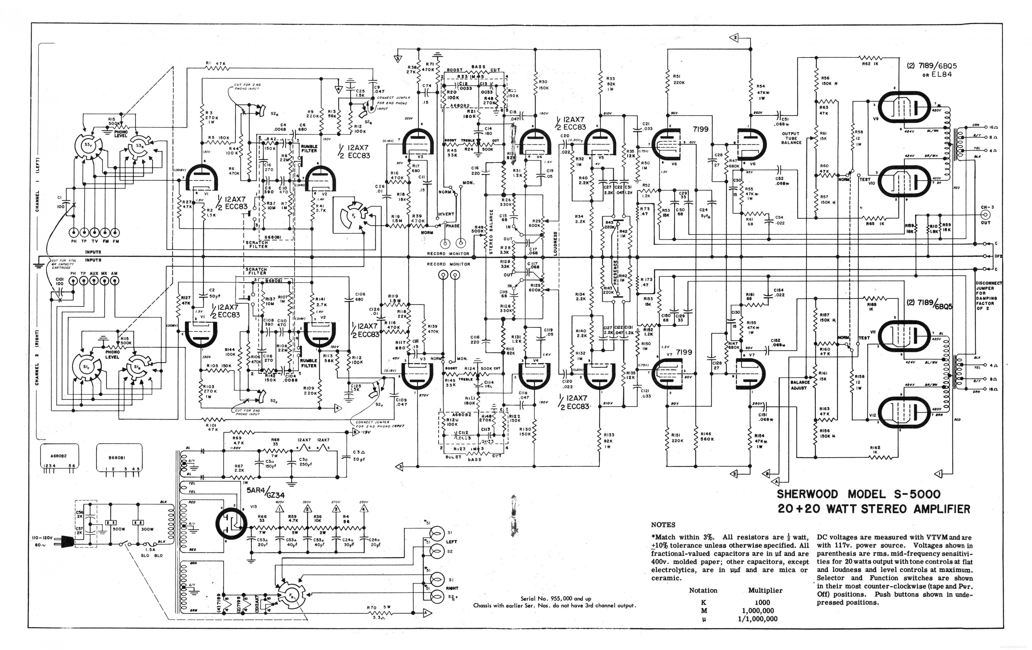

Sherwood squeezed 20 WPC out of 7189s in their S5000 integrated amp. Whenever a GNFB loop is employed, magnetic headroom in the O/P "iron" is essential. Lack of magnetic headroom leads to core saturation and wretched sound.
For 20 W., use "iron" rated for 35 or 40 W. Unfortunately, none of Hammond's offerings is really suitable. Rated at 50 W., Edcor's CXPP50-8K is "overkill", but definitely will work and may, in fact, be the least expensive option.

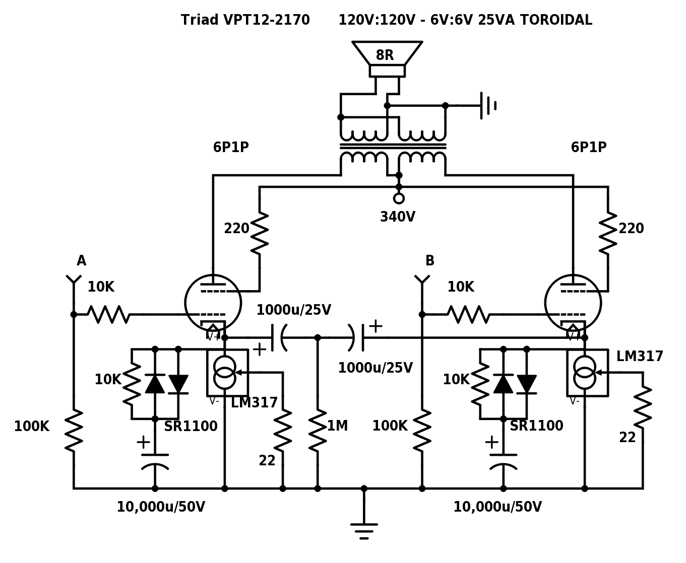

I use this circuit. More complexity but less expensive to build. Ignore the 340V as I designed it to push worn out tubes 🙂
"The constant-current source is only being shunted by a 10k resistor, which can be safely ignored. On the other hand, if the crescendo takes an output tube outside the class-A envelope, the rightmost diode will begin conducting and effectively couple the capacitor to the cathodes, which will greatly limit their AC movement away from the established DC bias voltage. Of course, if the increased volume is sustained for long enough, the capacitor will charge up to a much higher voltage. But once the volume falls to normal, the leftmost diode will begin conducting, allowing the capacitor to discharge through the constant-current source."
"The two large capacitors effectively couple the two cathodes in AC terms, but allow each tube to find its own DC bias voltage. The 1M resistor establishes a polarizing voltage across each capacitor." John Broskie.

This and the presented schematic with auto bias and 340 V +Ub works fine with
Hammond 1650FA. No more than 15 W can be expected.
