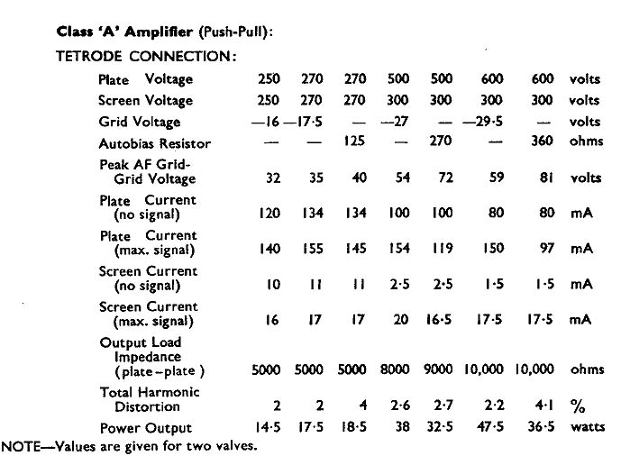

Below is a clip from the STC807 dtatsheet for class A tetrode for one pair of tubes.
807
I am building that 6DJ8 to 6SN7 to triode connected PPP 807s. I'll use cathode bias and 440 volts B+ with about 400 volts plate to cathode on the 807s. Although a pair shows up on tube data sites with 3000 ohm anode to anode for a pair, I will use 4300 ohms anode to anode for four tubes.

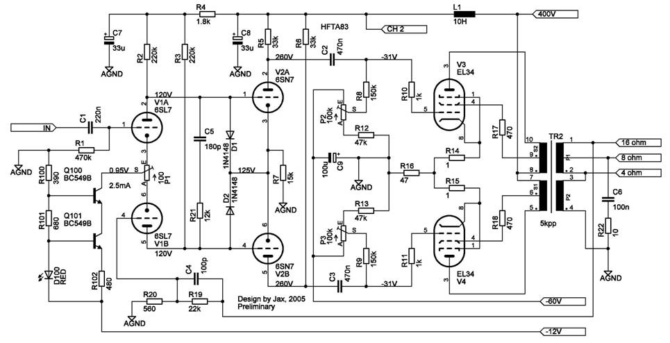

Jan,
A nice simple circuit - simple circuits have simple problems - simple problems have simple solutions - therefore I like it.
In a light hearted sense - here is your design review:
1) I don't like the resistor capacitor across the two anodes of the fist differential stage - separate series resitor and capacitor network across each anode load is reputed to better.
2) Should you ever contemplate using anything other than EL34 then the R8,P2,R12 (and the similar network on the other side) needs modification to reduce total grid circuit resistance. This combination is giving about 250K Ohms (at DC) from grid to 0V. For KT88 or similar you want to get this down to at least half - that is not more than say 120K - the driver stage will cope with this OK.
3) Unless you are running pure Class A - which I don't think you are, you should probably bypass R16 with say a 470UF to 2200uF high quality electrolytic (a Blackgate or Nichicon Muse etc.)
4) C7 and C8 could benefit from a 100nF film cap across them. Very occassionally this may introduce slight ringing - if so put 1 Ohm in series with the film caps. (Polyester would be fine - no need to go to polypropylenes).
Otherwise I give you a 9 out of 10. Congratulations.
Ian
