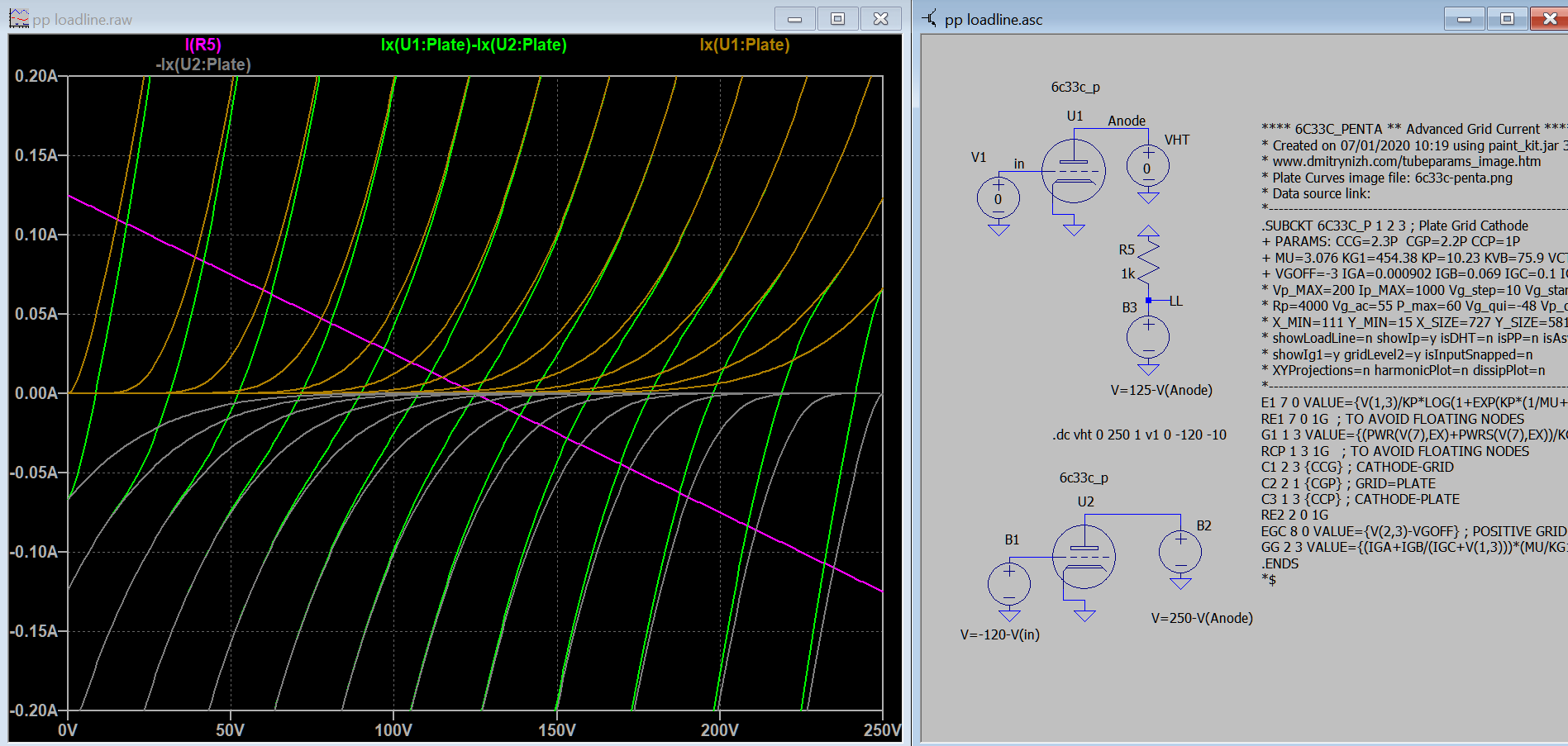

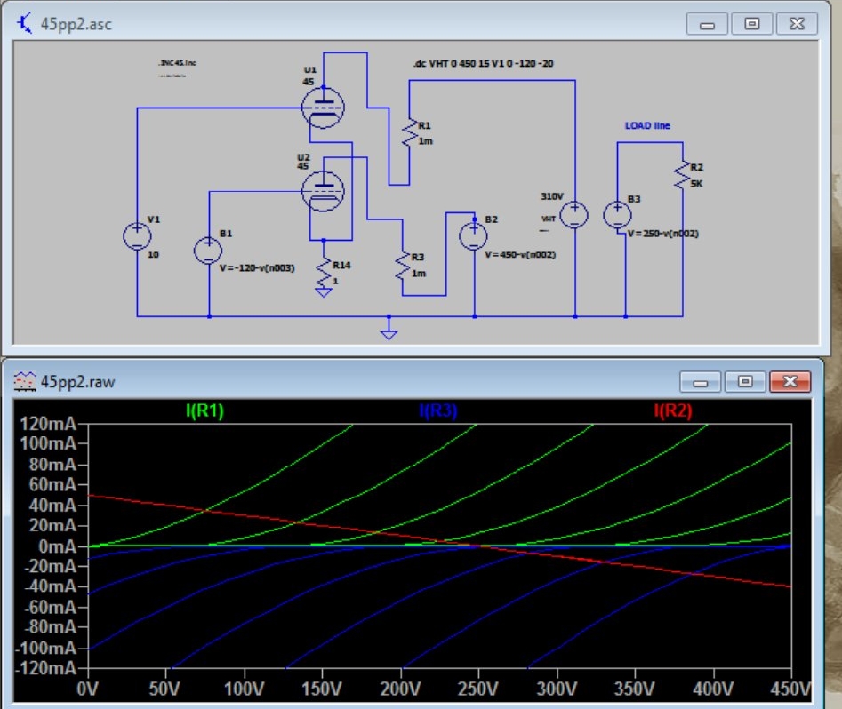

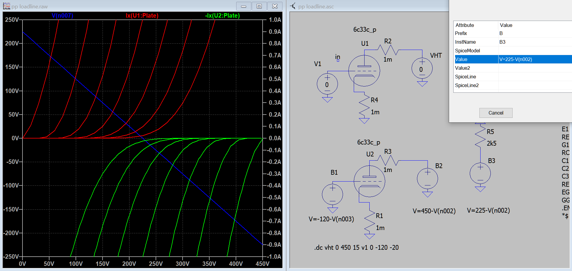

Use bv (arbitrary voltage source) in ltspice,
but some how, ltspice does like v(vg) in bv ...
I have to use the numerical node number like v(n002) in bv !
Dmitry Nizhegorodov's page 3.4 is helpful.

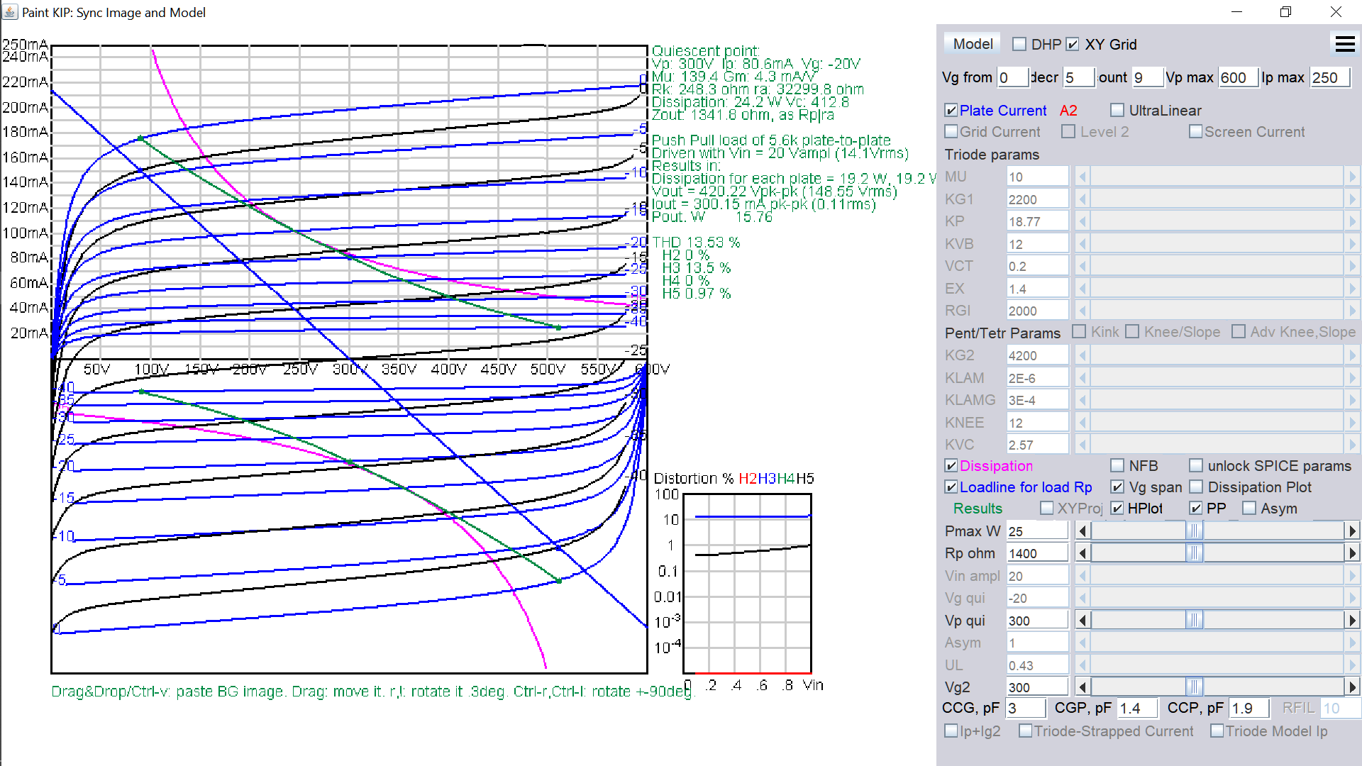

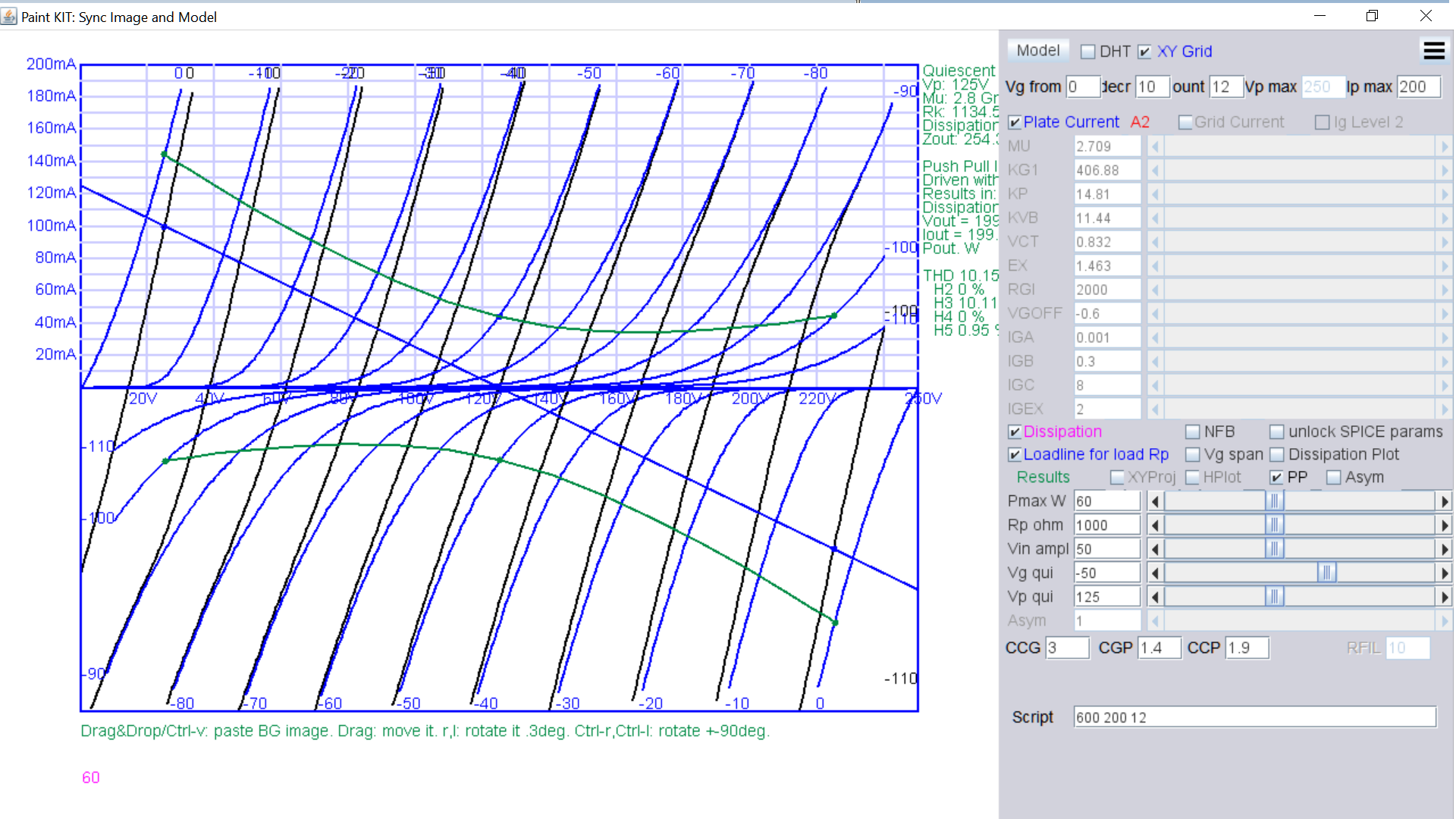

But pp loadline is found in the paint tools PainKIT (triode) and PaintKip (Pentode).
The good thing is you can paste any working model into the text window by clicking on Model and then Update params, you have completed model. Then select PP in Loadline and other icon, it is all interactive.

Got it working after the component attributes changed to "B" otherwise it wouldn't work. Thank you very much.
Instead of using V(n002), can use V(in) where "in" is the label port name to replace V(n002).

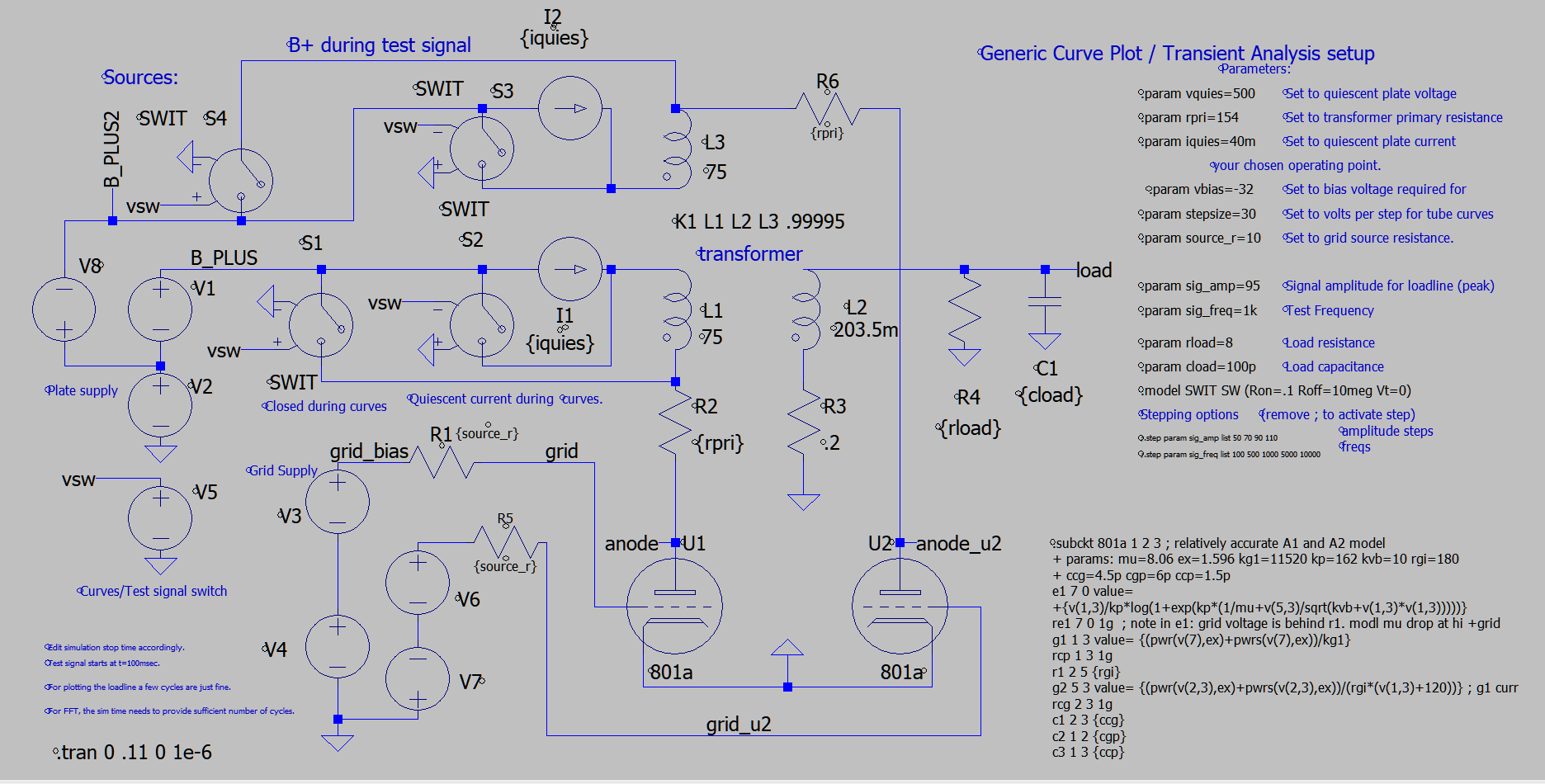

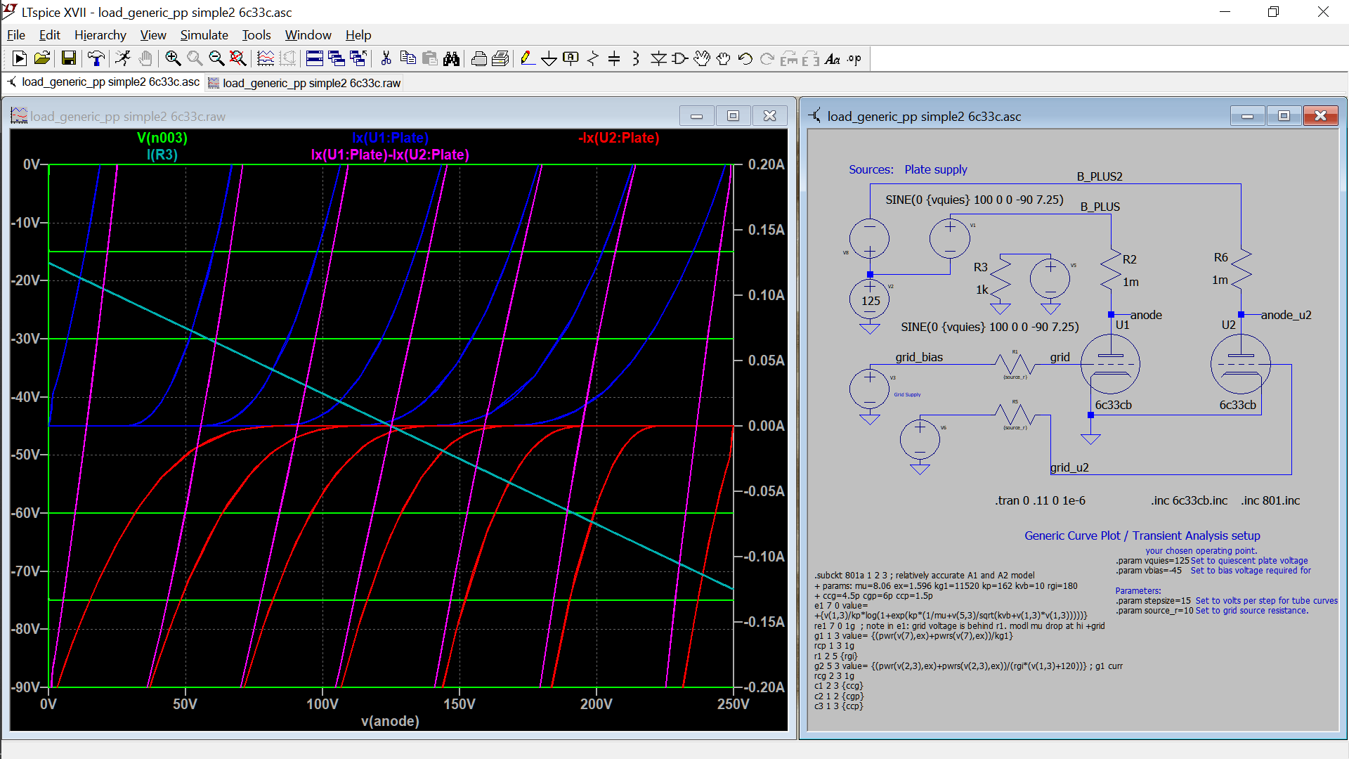

Above is another approach: transient analysis for curves as well as transformer amplifier output. you can download it, remember to set the Horizontal axis to V(anode) or time for it to display correctly.
I have made a simplified version, and it's comparable to previous version using .DC analysis, but curves tracer generator is much more complex, and a bit difficult to set the bias voltages begin from 0. Feel free to comment on the correctness of simulations.
:: View topic - Generic push-pull loadline
I don't think the sine and the steps functions matters
in DC analysis.
I had trouble with your load_generic_pp simple2 6c33c.asc
doing DC sweep. Ltspice complains "previous analysis already found."

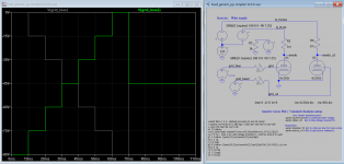

So I used sbench's schematic to validate my claim. I may be wrong.
I *think* sbench intent of these examples is to show
how the same schematic can be used for both DC and transient
analysis by using a switch.
in DC analysis.

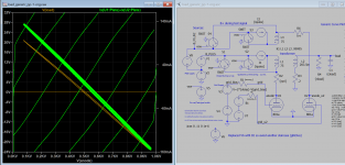

"previous analysis already found." There maybe another analysis found, I found very few info on this case using Google. Sine wave is strictly not a straight curve but ellipse curve you can see when zoom in. But what I meant is you verified my sim before using it, not to compare on the accuracy of approaches separate, is there another approach?
I deleted the 801a model directive on the bottom left corner, the error no longer appeared and it seems to work with .DC sweep at the V2 voltage source and give a perfect straight curve line! So V3 stepping is working.
It is a push-pull transient analysis plotted as IV curve.
Very very nice !!
What I said in post #9 is incorrect.
I modified your drawing just a little bit,
I've also include a plot file for the sake of completeness.

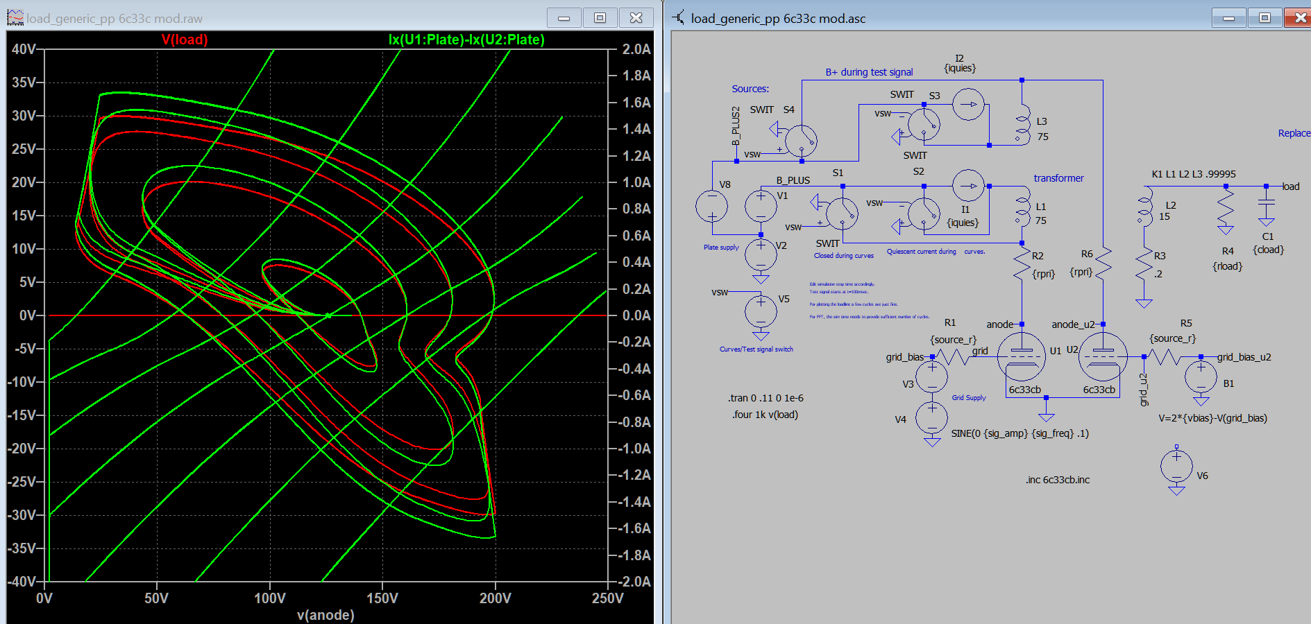

Here is 6c33c version, replaced V6 with B1 as fossa indicated. The settings are differences from 801a, you have to adjust several times to get it working correctly. I haven't modified others because it might have glitches here and here but feel free to improve it.
