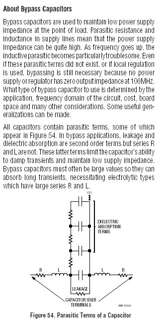

Bypass
They use bypass capacitors because the electrolytics don't work too well with high frequencies.
That means the resistance of the electrolytics rises at higher frequencies.
So what they do is to bypass them with smaller caps of a better quality. Usually with polymer film types but you can use ceramic caps too.
They use different values because the smaller a cap is, the better it performs in the higher frequency range.
This way they combine high capacity with good high frequency performance.

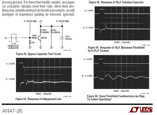

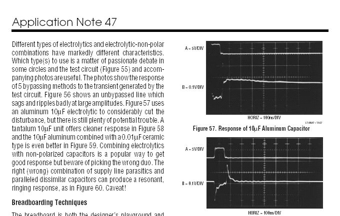

When we design an amp we assume a "battery" as power source and we also assume that the voltage has low impedance at all frequencies (beyond the amp's upper limit). Why? Because amplifier theories assume low impedance power supply voltage. If we have too high imdedance we get unpredictable reasults, may colouring the sound.
Let me also point out that the method of bypassing can be a science alone. Linear had a document about that when they have measured a couple of circiuts.
http://www.linear.com/pub/document.html?pub_type=app&document=50
This application note describes the technical aspects, not the audiophilic, but it is very educational with lot's of pictures and practical circuits (this I like).

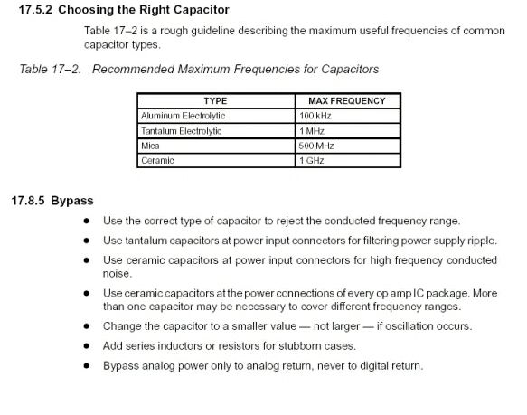

Real USEFUll stuff.
Now this is real good stuff, thanx alot. Everybody should check it out!!
peranders said:Let me also point out that the method of bypassing can be a science alone. Linear had a document about that when they have measured a couple of circiuts.

Abstract from this document:
- Purpose of Bypass caps
