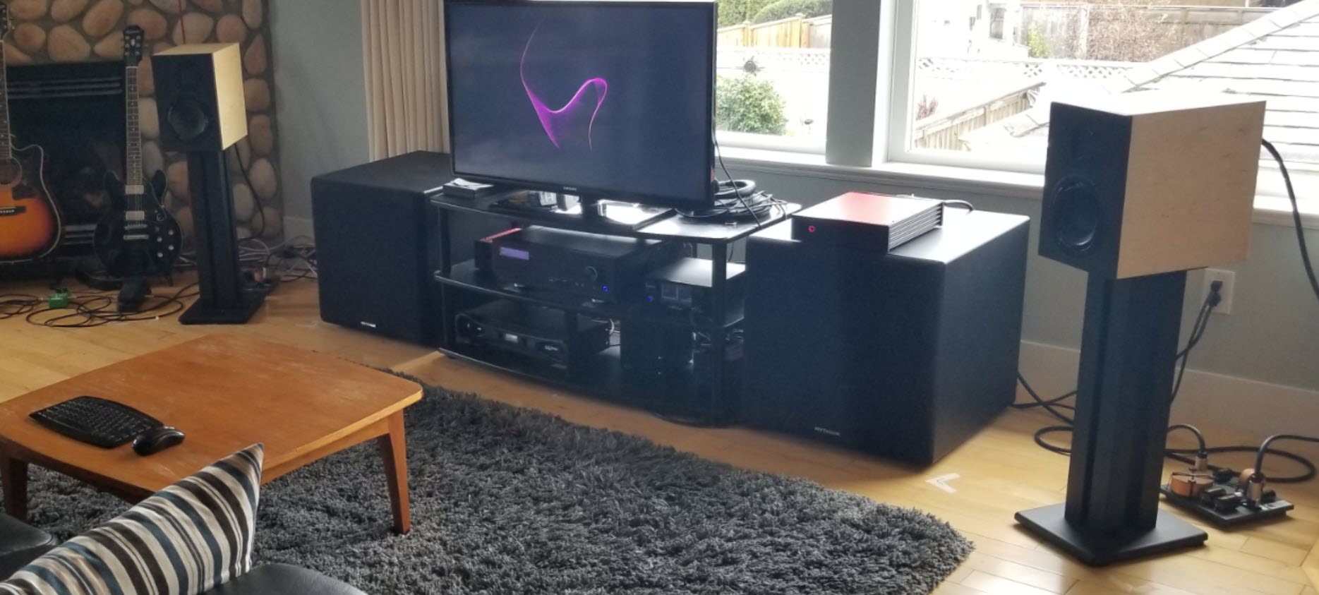

I'm exploring the merits of internal vs external locations of the crossover for the Purifi SPK5 Demo Speaker design. For convenience I would prefer an internal crossover but, given the compact cabinet dimensions, I'm concerned about the close proximity of the inductors and drivers.
I would appreciate advice on whether it would it be reasonable to mount the crossover on the back of the internal brace (marked in red in the attached image)? Thanks!

I reviewed the Purifi SPK4 Fantastic! The external passive crossover is pretty big. Not sure what XO components are intended to be used for SPK5, but there is no way this crossover can fit into the SPK4 cab. The passive XO's sit behind the speakers...
Thanks. I don't yet have the drivers but have built the cabinets and ports and as far as I can tell, there will be sufficient room to fit the crossovers on the side panels if the HF and LF sections are split. The cabinet will need to be increased slightly in volume to allow for the additional real estate occupied occupied by the crossover components. Having said this, it does seem, in looking at your images that the crossovers are quite substantial and may be best located outside the cabinets.
I would make a seperate section below the speaker cabinet to put that big crossover. It makes them a bit taller, but it's easier than with the crossover outside i think. I also have the crossover outside my cabinets (so i could change them fast before they were finished) now with my diy setup, but i'm going to build some boxes to put them in, it's not handy open in the rack...
Good suggestion. I could increase the height of the cabinet by about 80mm to accomodate the crossover within a seperate section. It would be a tight space with little to no ventilation. Not sure of this will be an issue.
you can "port" it, leave a small horizontal slot open on the backside of that space for airflow. It won't affect the sound, and if it's 1cm high and 5cm wide it will be more than enough to dispensate the heath that the crossover generate... To avoid curious child-fingers and dust entering, you could add a kind of grill to it.
