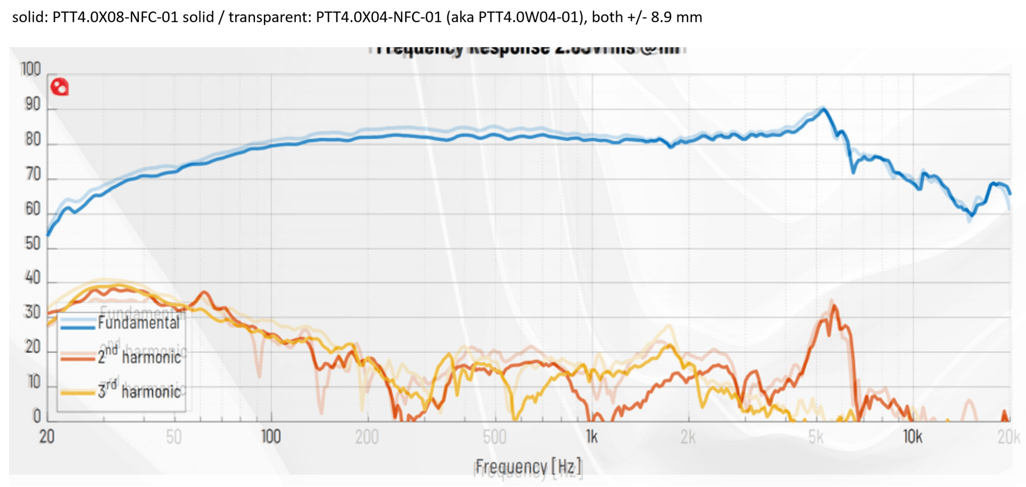

Here_s the first such pair as a null hypothesis - coil resistance should not matter, so let's see:
4 inch, paper, extended stroke, 8 vs. 4 Ohms
The 4 Ohm version has about 2-3 dB higher SPL for the same voltage, harmonics on average are about 4 dB higher (eyeballed). FR and harmonic structure are very similar. However, between 1 and 2 kHz, HD3 is about 10 dB higher, which is strange. This is about the most mismatched 4 / 8 R pair I have found.
