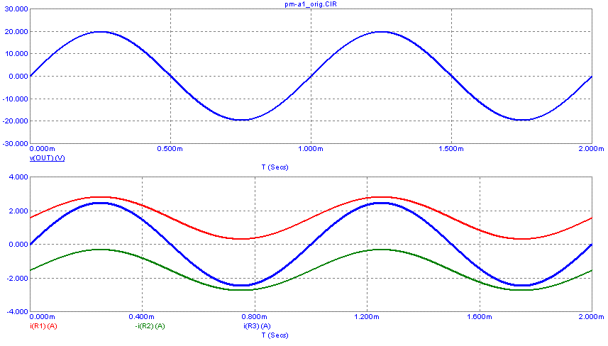

A push-pull ClassA amplifier is biassed to half the peak current into the worst (normal) load the speaker can demand. The push-pull can deliver much more than ClassA peak current if allowed to do so (but not in ClassA, it automatically converts to ClassAB when overloaded, but without the enormous increase in distortion of the single ended version).
Lets set up the PSU and active devices as for the single-ended. 30Vdc and 2.1A of bias.
The upper active devices pass 2.1A and the lower active devices sink this same current. As shown in those earlier graphs the upper device changes current with signal level and the lower device changes current in the opposite direction. The difference in current between the upper and lower devices is delivered to the load. The ClassA limit for this is approximately two times the bias. so if biassed to 2.1A the maximum ClassA current to the load is about 4.2Apk. if this is pushed through a 3r0 load then it needs Vpk=12.6V. exactly the same as the single ended. The maximum 8ohm ClassA power is also the same as the single ended.

the upper device supplies all the current, provided the PSU can deliver and provided the designer has not incorporated current limiting. The lower device tracks the upper device as before until it's minimum current drops to a very low value This is the lower transistor effectively cut-off. The amp is no longer in ClassA. The big difference now between single-ended and push-pull is that the cut off transistor does not cause gross distortion, it simply takes no part in controlling the output current. For negative peak current the opposite happens. The lower device sinks extra current and the upper device sources less current as the signal changes. Again the limit of ClassA arrives when the upper devices cut-off.
Now look at the device dissipation of the PP ClassA 30V*2.1A=63W but shared equally between upper and lower devices AND it's capable of delvering twice the ClassA current. That is a very large increase in output/input efficiency and each device dissipates just half the power. No wonder Push-Pull is so popular.
The definition I adopt for Push-Pull ClassA is that both devices must actively control the current in the load with neither becoming near constant current and/or cut-off.
