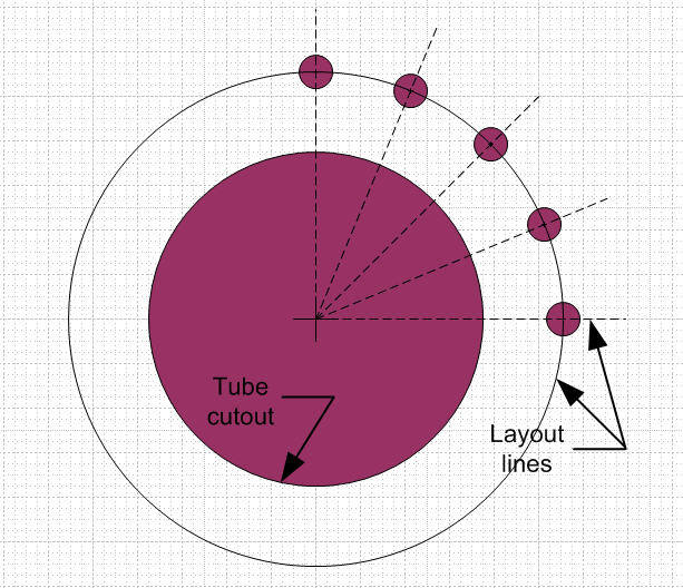

The way I do my top plates allows for easy hole alignment. I use a program like Front Panel Designer or PowerPoint to lay out the holes. I then print it out and tape it to the plate. Use a spring loaded center punch to mark the centers of the holes and guide the drill bit. Very simple and effective to make accurate patterns at home.
I've used them, they're actually a pretty good size. The smallest one is 7/8" which was just right for my 9 pin sockets. The problems is that while they are the right size, they're built like crap. The punch cracked halfway through my first hole! I managed to carefully make it through 3 1/2 holes before it finally cracked in half. 🙁

I lay it out in cad (use whatever drawing program u know), print it, and drill it. To get perfect holes, pre drill it w/ a tiny bit, or punch a little divit in the middle of each future-hole.

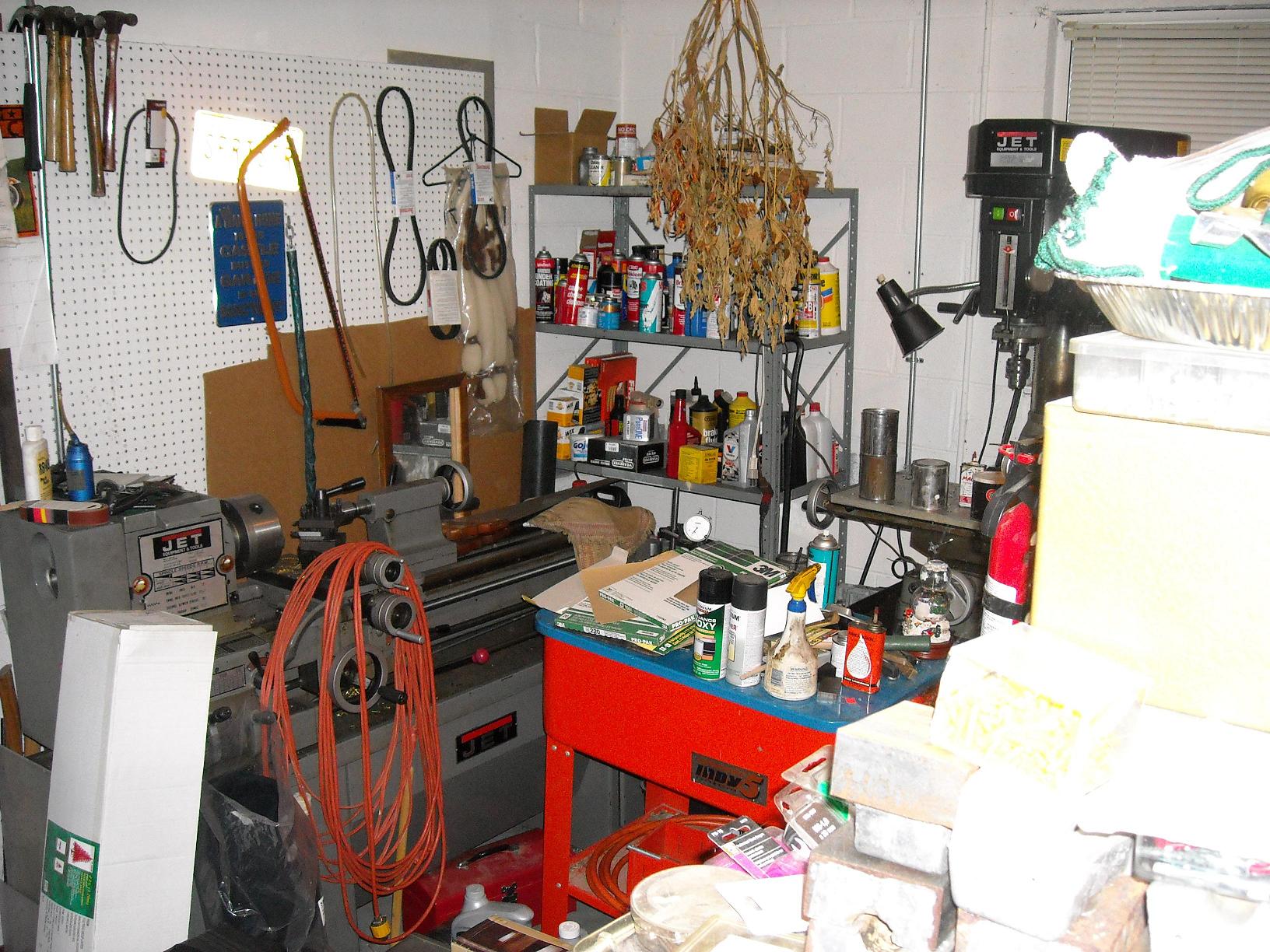

I currently have to climb over the model railway and the stacked console and jukebox chassis and past the stacked furniture to get to the roller door that must be opened to put the drill stand outside before i can drill one hole. I normally trip over the arc-welder or the drop saw on the way.
I understand your dilemma...
