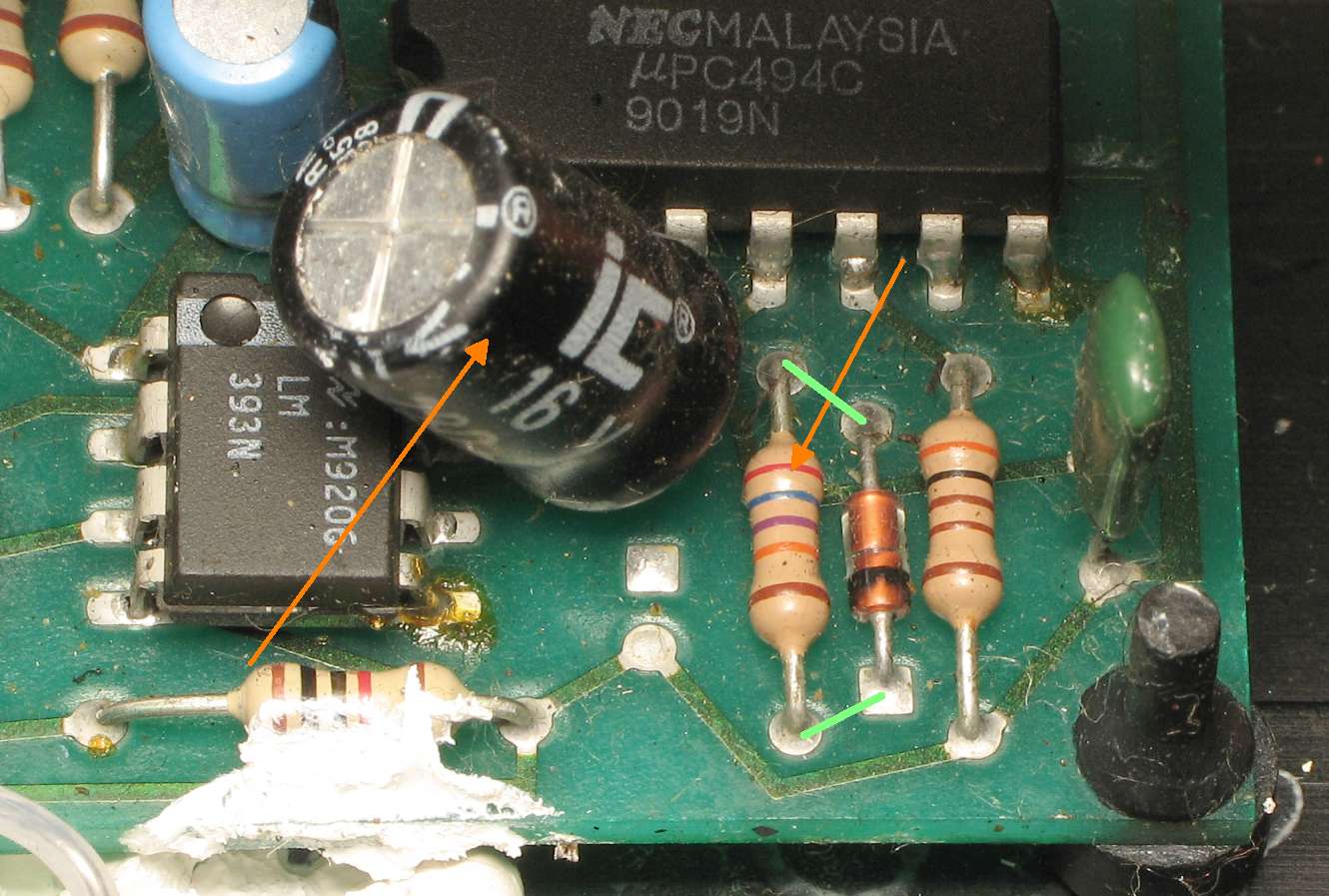

When I put my test light to the negative side of this diode I get power and the amp works correctly. What is this issue? I checked the diode and it is good. Even replaced it so I assume it is another component.

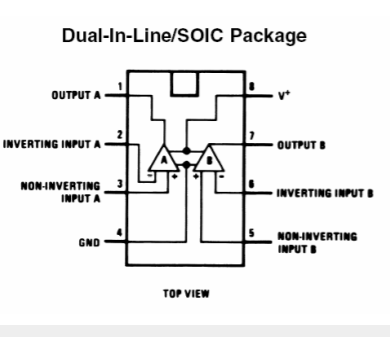

Post the DC voltage on all terminals of the 8-pin IC adjacent to the TL494. Copy and paste the following list and fill in the blanks.
Pin 1:
Pin 2:
Pin 3:
Pin 4:
Pin 5:
Pin 6:
Pin 7:
Pin 8:
Pin 1:
Pin 2:
Pin 3:
Pin 4:
Pin 5:
Pin 6:
Pin 7:
Pin 8:
For testing, install any high-value resistor. If you have something near 100k ohms, that's OK for now.
