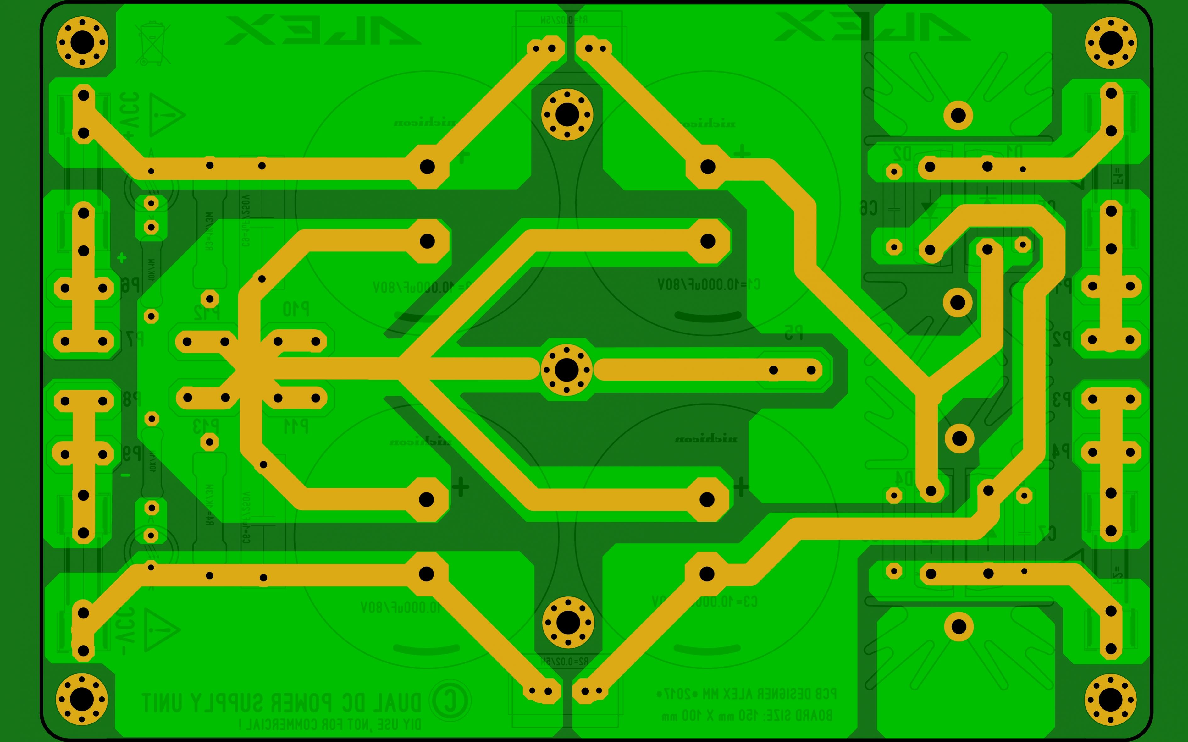

Hi Jared C79
I have layout this attached PCB , I hope it's what you need 🙂

In your PCB design you force filter capacitors charging return currents to turn at 45 degree which makes it a perfect antenna for mains hum. You also force charging return and load return currents to go the same route which seems to be not so good to keep the GND potential stable. I would suggest to make one big copper pour for the GND without separate traces to all capacitors.
You also designed your PSU PCB for center tap transformer since you provide only one connector for the center tap. This makes it more difficult to use your PSU PCB with dual winding transformer. Instead of providing two connectors for the transformer upper/lower taps (which seems redundant) it would be better to allow for a second center tap connector (where two transformer secondaries can be connected in series).
You also seems to have redundant fuses on board. I think it is much safer to use fuses at the AC side than on each DC rail. This is because if one fuse on the AC side goes open you do not lose the DC rails, just the current capacity goes down and voltage sug increases which is typically not so bad. While in case of real failure both AC fuses will go off saving your circuit downstream. In contrast, if any of the DC rails go off due to single (DC side) fuse rupture your speakers face half (or full) rail DC voltage which they may not like.
