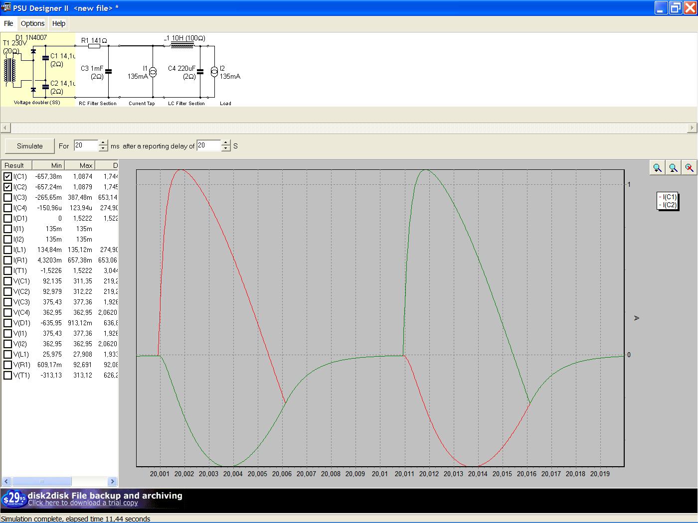

I need a PSU that can supply 365V and 2 x 135 mA.
230:230 I have some in stock. Now I will make a bad voltage doubler.
For this, I need a pair of pump capacitors which are being abused (see attachment).
The start up current will be 65A at the start, decreasing to 1.2A.
Electrolytes are unusable, the voltage is clean AC to begin with.
14.1 uF is 3 pieces 4.7UF parallel.
I have some Solen Fast 4.7 uF / 630 V / MKP. Can they do the job?
Regards
