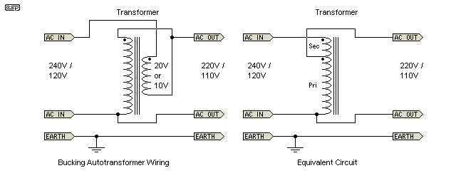

Still pretty hot. Add a bucking transformer? Shaving 40V off the primary voltage would get you close...

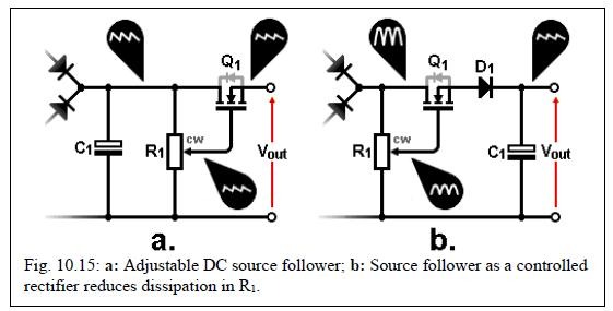

You haven't told us what the rest of the amplifier looks like. Average current demand? Or did you mean the entire finished amplifier will only draw 5mA? If it's that small you could add a simple MOSFET follower (capacitor multiplier) to reduce the voltage, since it would burn away less than 1 Watt.

But if you only need 10mA then a capacitor multiplier or MOSFET follower would be easy and cheaper to implement.

Ah alright, how would I go about picking a suitable mosfet and potentiomer for a circuit like that then? Would be nice and small too which is a bonus but I am a bit concerned about the inrush exploding the mosfet like the zenersNo, a buck transformer drops voltage continuously, no switching involved.

OK. 355Vac =>
Bucking transformer: Something like this with sufficient voltage to ge you to 450 Vdc. (Described on Rod Elliotts website)

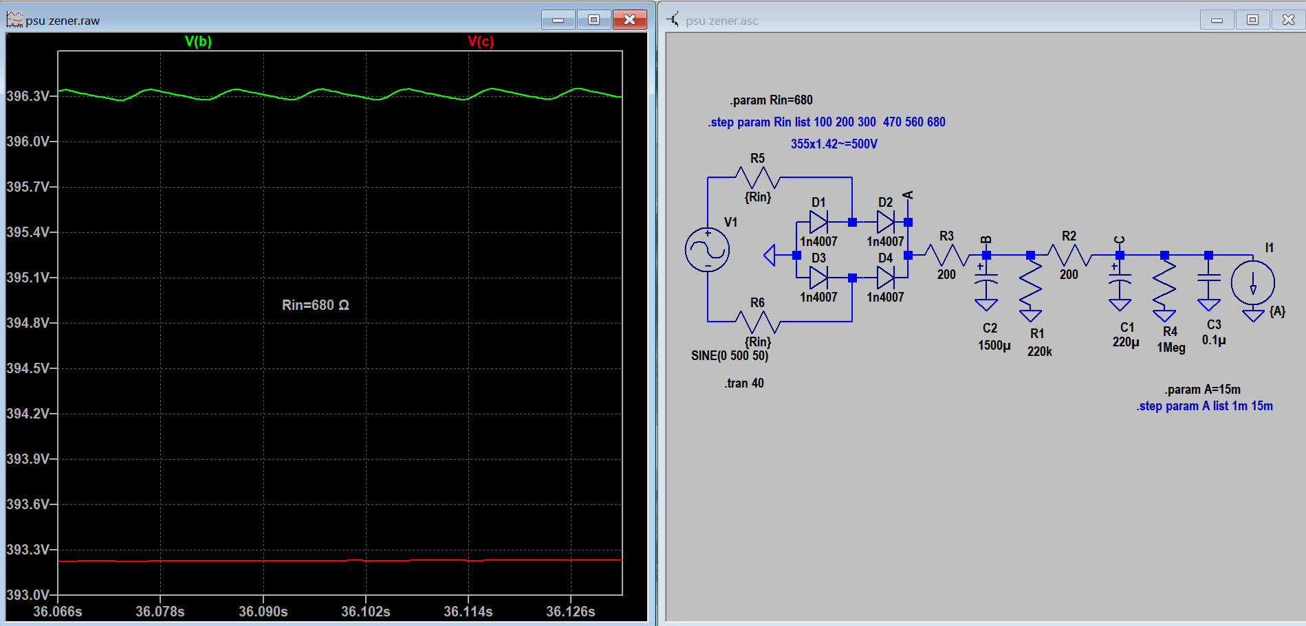

Should have explained that the suggestion is the smaler cap and an R (or L if you could fit one) in front of your existing PS. Play around with PSUD2 (https://www.duncanamps.com/psud2/j if you know it to see what you could do in this regard. I get it that you want to do as little as possible on the PS you already built.Or, I might try a much smaller input capacitor (say 8 mF, DC-Link or oil to handle the ripple current). Your first cap is pretty big.

Smaller cap is probably not happening at this point as the case is built around it. A changing the 10ohm inrush resistor to something much larger sounds like the solution then as I don't think I can fit an inductor of more than a few mH anywhere.Should have explained that the suggestion is the smaler cap and an R (or L if you could fit one) in front of your existing PS. Play around with PSUD2 (https://www.duncanamps.com/psud2/j if you know it to see what you could do in this regard. I get it that you want to do as little as possible on the PS you already built.
So resistors before the transformer as well? Any benefit to them being there rather than after?Can this sketch solve your PSU problem?
You can use copper winding resistance in the secondary in addition to the added resistor to your advantage, if you added it to primary, it will work (maybe slight mismatching of impedance) and loss of power drawn.
You don't need an actual pot, it just represents how you could set the voltage, you would use fixed resistors. Any 850V+ MOSFET should be fine, bigger the better (bolt to the chassis with suitable insulating hardware). Include a current-limit so the inrush cannot damage the MOSFET. Here you go, 600V in, about 450V out, limited to 60mA. Q2 can be any general purpse NPN. Easy peasy.Ah alright, how would I go about picking a suitable mosfet and potentiomer for a circuit like that then? Would be nice and small too which is a bonus but I am a bit concerned about the inrush exploding the mosfet like the zeners
Oh cool, thank you! Is the cap behind the rectifier my 1500uF one? And if so would it be fine to move it to the other side of the MOSFET? The main reason that the 600V is an issue is that that cap would die pretty fast at that voltage 😅 (the caps in this amp are already specced for a good time not a long time but you know, don't need them to explode day one)You don't need an actual pot, it just represents how you could set the voltage, you would use fixed resistors. Any 850V+ MOSFET should be fine, bigger the better (bolt to the chassis with suitable insulating hardware). Include a current-limit so the inrush cannot damage the MOSFET. Here you go, 600V in, about 450V out, limited to 60mA. Q2 can be any general purpse NPN. Easy peasy.
