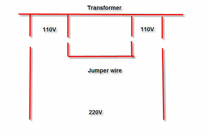

Well, I have run into a small issue constructing this PSU - I ended up using 4 pcs. of 20-0 volt, 150VA transformer - using two for each channel, giving 20-0-20 volt. I have hooked up the transformers, and get 20 volt on the secondary - but I have a h*** of a buzz - mechanical, 50Hz buzz. I have connected the transformers as shown in the attached picture - they have twin 110 volt primarys, which I have wired in series for the 230 volts in my contry - but i am in doubt if I should reverse one of the primarys? Or should I go for a DC filter on the primary?
Kind regards
Hans

It does sound like your primaries are out of phase if you have no load on the secondaries. Try it with a 1/2 A fuse on the primaries,if it's out of phase it should blow the fuse.
300va is enough for one channel, it should work.

Hi Bill - thanks for the answer. And yes - when we are talking about slow projects, this one takes the prize!! Do you mean that without load on the secondarys, the transformer is likely to buzz?
In Denmark, and in fact all of EU, we are not allowed to have phase indicators on the power outlet, so guessing which is phase is quite hard - however it can be measured 🙂 I have tried to switch phase, without audible difference, but maybe that will change with load.
In the meanwhile, I have played around with different configuration - putting two of the four transformers in reverse to the other two, rubber insulation between transformer and cabinet etc. - and I think I will go with the rubberfeet, which definetely helps, and all transformers in same phase - that way I can switch the phase by rotating the mains plug 180 degreees. Will also do an external DC blocker with a couple of caps and diodes.

Hi Hans,
I was speaking of each individual transformer. Are you sure you have the 2 primaries series connected in phase with each other. If they are not the transformer should blow a 1/2amp fuse without any load applied. But if you have the amp operating I dont think that's the problem.

No, I do not have the amp working...yet - I am in the process of assembling it, and was doing tests on the PSU when I discovered the buzz. I have tried the phase reverse the primarys, without any noticeable difference in buzz, so unless the DC filter helps out, I think it is just a case of bad transformers 🙁
