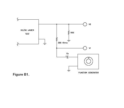

When I build a PSU like a shunt or serie regulator, I am very interested in the output impedance.
Please look at my attachment and tell me how to calculate the output impedance???.
An exsample with my shunt reg, which is fed from a regulated psu (B&O):
Wavegenerator output = 10Vpp from DC to exsample 100Khz.
and generator output impedance = 50ohm
Output voltage shuntreg DC = 20V
Measured with point RDC 100Khz@2.5mVpp ac. (scope say 2mv with shortened input because off noise in ground wire from regulated psu, else 1mv input shortened)
Can I avoid this groundnoise somehow?
Best regards
Kim

current flows in loops, the current in your ground return is equal and opposite the current injected into the V2 line by the function generator
you will have much more success in electronic design if you trace out the complete current loop for any signal and understand the impedance in voltage drops induced in all parts of the loop, especially the "ground"
if you pick one physical point in the circuit you can call it ground, for measurement the function generator and oscilloscope should both be connected to this same ground point

In your schematic you have a signal current going through the 300 ohms into the supply. That current is generator voltage / resistance (ignoring the small ripple on the supply), so for 10Vrms out of the generator your current is 10/300 = 33mA. Your resulting ripple is 2.5mV. Ohms law thus says that the supply output impedance = 2.5mV/33mA = 75mOhms, which is not so hot.
The problem here is that with these low impedances, you have to be very carefull where to measure. For instance connect the 300 ohms at the supply point where the feedback resistor is connected, and measure with a separate wire at the same point. You can easily get an order of magnitude variation depending how/where you measure. In your circuit, the wire coming from the "DC/DC under test" to the 300 ohms could easily represent most of that 75 mOhms.
That also means that you get only the benefit in the actual circuit if you connect the load at the same point, of course.
Jan Didden

If you post a schematic we can see where to measure/connect the load for best results.
Ground noise/ripple I think is more a function of layout and construction that getting rid of the regulator. The regulator as such will surely have less ripple/noise than the bare rectifier etc, but you need to take care of the implementation to keep it.
Jan Didden

No. If you divide pk/pk you get the same as rms/rms, the 2.something will factor out. Try it!
Jan Didden
