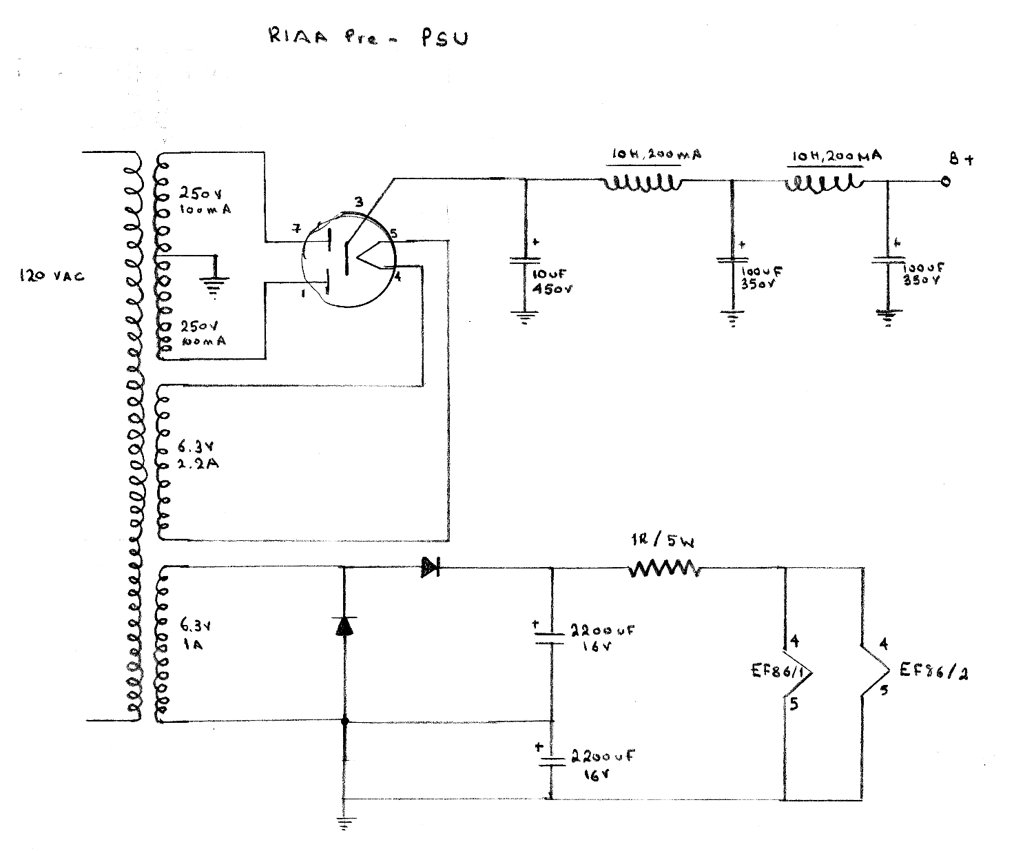

Feel free to LOL! This is my 1st design which is really a hodgepodge of other people's work. Anyway, it's to power my EF86 based RIAA pre using some parts I already have.
Big Q, will it work? I had a tough time getting my head around the 6CA4 seperate heater/cathode thing.
Any & all input would be appreciated, forgive the pencil drawing but I haven't found a simple symbol program for my Mac (don't start-OK).
Thanks, Philip

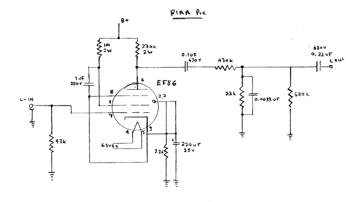

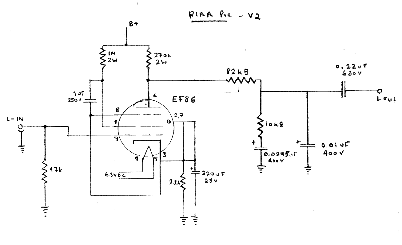

OK that's the PSU post with the pre-amp schematic. Here's the preamp post with the PSU schematic just to keep everyoner on their toes!
Same questions, will it work? Will it eq per RIAA curve? Will you be able to read my chicken scratch?
How about using a single 20H/450ohm choke in the B+ (since I have one)?
Thanks in advance.

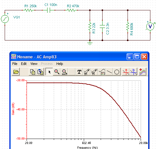

Nope. I think it has the 2KHz-20KHZ drop, but no 500Hz-50Hz rise. See simulation below, ignoring pentode gain (about 40dB-46dB) but accounting for pentode plate impedance.
Output impedance is quite high, can't drive much/any cable. And you can probably eliminate the 470K resistor.
Pentodes have more noise than triodes. In phono amps, it could matter.
Otherwise it all looks fine.

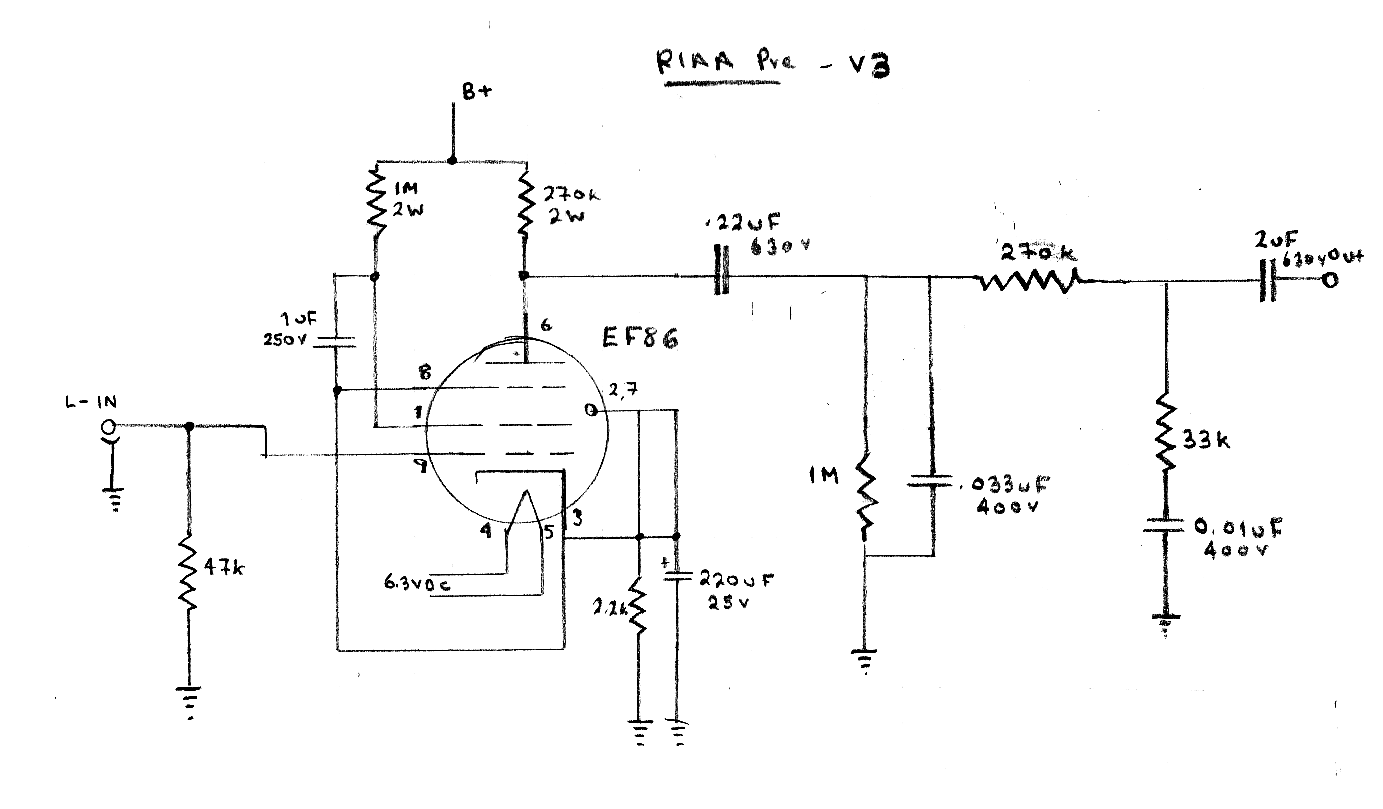

OK here's the next revision. Check it out!
I'm actually 42 years young and I always stick with uF 'cos I'm pretty new to all this & it saves me confusion!
Thanks for the input.
Philip
PSU - how about this (trying to use stuff I got):
1 - replace 2 x 10H chokes with 1 x 20H/450ohm
2 - remove 10uF cap, place 100uF cap either side of choke (total of 2)
