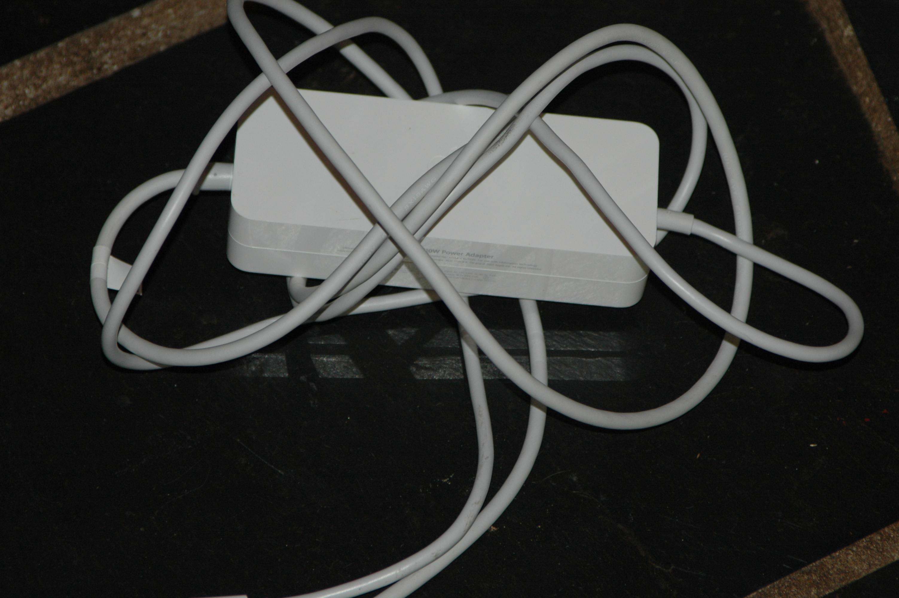

FWIW, I have been in touch with Dave at PI recently regarding what the options were with my 09 Mac Mini. His suggestion was a HDD SMPS Buffer that had an option for additional outputs. I'll let Dave quote pricing but let me just say that it seemed reasonable.
The other option is a linear power supply around a $1000. I have concluded from people "in the know" that the MM '09 isn't worthy of the expense.
I would also characterize opinions as less than enthusiastic about battery supplies for MM 09's.
I was looking at rigging up one of these Carnetix to plug into a battery supply, but I decided the hassle wasn't worth the improvement. BTW, there are interesting reads regarding the subject of computers in Auto's. As you probably know, the Auto enthusiasts are nuttier than audiophiles.
Pics of the MM 09 power brick and plugs:[/ATTACH]
