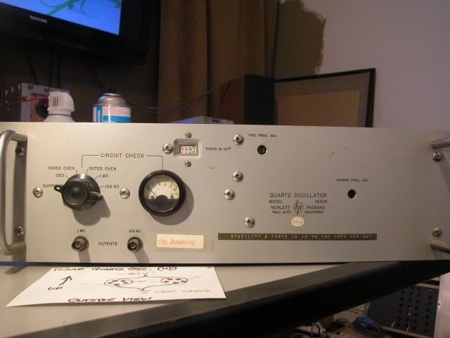

I just bought an old (1965) Hewlit Packard 103AR.
100KC and 1MC sine outputs.
It's a transistor based unit.

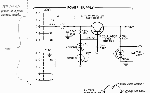

By looking at the 103AR's power input portion of the schematic, it seems to be negative 24 volts:
(there are two jacks, but only one is used. Ground is tied to case, -24v to circuit, I visually checked.)
I just want to do a "dead or alive" test. Do you think it's ok to use a properly set-up Lab PSU, @ -24 v...?

if its isolated it won't matter. it will either be 20V or -20V depending on which terminal you call ground. I haven't read the manul, so doublecheck this.
I've never used a psu that was hooked-up for a negative supplied circuit.
From what you suggest, this just a matter of using a regulated or unregulated +24v psu, but attaching the power leads in reverse.

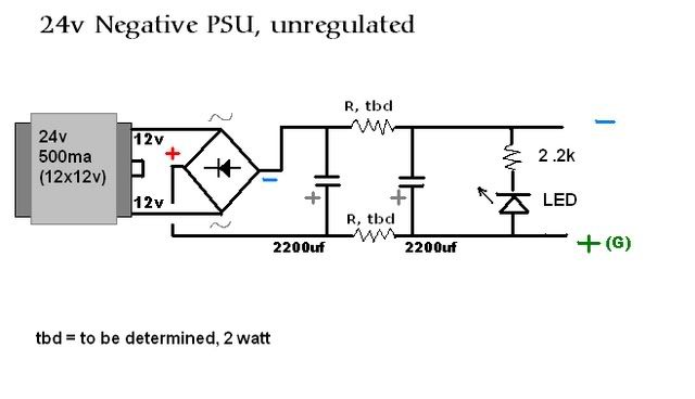

Pretend this uses a 24v regulator(7924):
(and other appropriate values/ xformer, etc.)
http://www.talkingelectronics.com/projects/ThePowerSupply/imagesP79/P79Fig33.gif
.....yes?
what about "isolation" ?

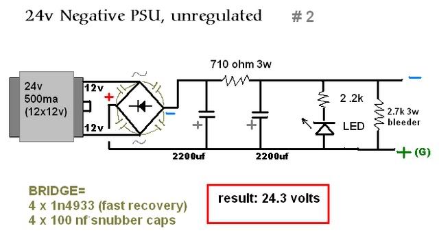

or Unregulated...
does this look good?

EDIT:
I think I see what I've done here, It's a normal +24v psu......drawn upside down
(I could probably come up with a diode regulated version too.)

I don't have much practice building single psu's. I've built many dual psu's.
The resistors between the filter caps, should they be on both rails, or just on the neg (non-ground) rail ? (I'm so used to doing psu's symmetrically, that I'm not sure about this .

I just built this.
I made a few changes....snubbers, and a bleeder resistor because the caps were staying energized for about 30 seconds.
What do you think ?

there may be some examples in the chip amp forum. many toroid power transformers have dual secondararies instead of merely a center tapped secondary.
people just build two isolated, positive regulated power supplies and hook the outputs up in series.
This works due to the isolation.
as for your schematic, it looks ok. use a 1/2 resistor for the 2.2k.
keep in mind that the RMS input current to such a circuit is fairly high, i wouldn't run the circuit you list at 500mA output for instance.
Whether or not the original PSU contains a regulator (based on vintage and the presence of the regulator inside, I'd guess rather not), your easiest option is a 24V switchmode wall-wart or notebook supply. Over here, you can get those as "new old stock" from surplus dealers at ~$8. Outputs are floating wrt. earth anyway, so as theChris mentioned, you can connect +24 to pin A (GND) and 0 to pin C (-24) on your HP.
You may also be able to use an 18-19V switcher that you can open and trim the output up. Your HP should run fine on 21V regulated based on the circuit you show.
Alternatively, use an 18VAC transformer or wall-wart, slap on a bridge rectifier and 4700uF 35V cap and Bob's your uncle (I bet that's what HP did originally).
