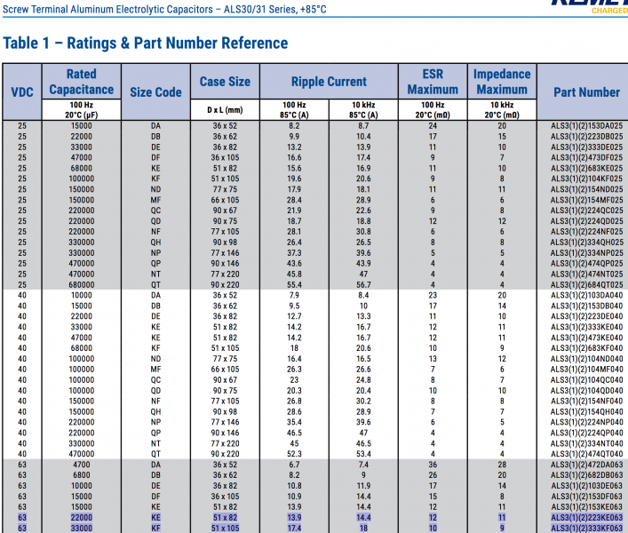

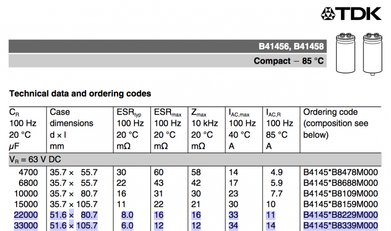

Has anyone measured capacitance on any of these in larger sizes (eg. 22,000 or 33,000uF)? I know tolerance varies but there's usually a trend.

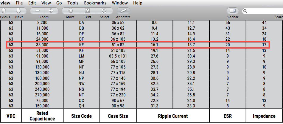

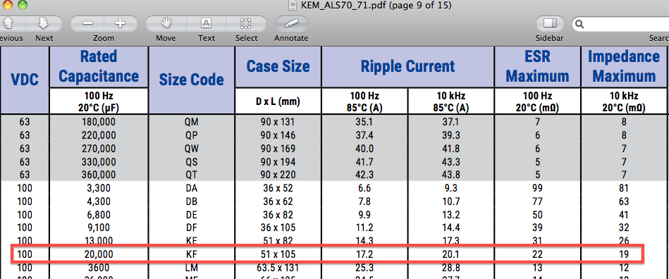

I have a few applications which all need 51mm diameter, and one in particular which needs a 22000uF in 75V or greater rating (which mandates 100V in most options). Most brands will jump up to 63mm for this, but the new Kemet ALS70 comes in 20000uF 100V at 51mm. I'm wondering what Kemet's measured capacitances are usually like, if they are on the higher side I'd give it a shot.
It looks like the Kemet/BHC have the best specs - higher ripple than the Epcos/TDK and longer life. Both are much better than Nichicon and United Chemicon for this application it seems.
I attached some datasheets just for interest, first two showing the 22000 and 33000uF in 63V for Kemet and Epcos, and another two showing the new ALS70 in 33000uF/63V and the 20000uF/100V which I'm interested in.
I'm open to other options as long as they are 52mm max, 75V+, and have ripple current comparable to these.

I wonder if anyone here has measured capacitance on Epcos/TDK B41456/458 or Kemet/BHC ALS30/40?

Though the best spec (current) caps in this voltage/capacitance are still the larger 63mm diameter, I have less options in the 51mm format. Perhaps the future will bring more, the ALS70 is a new option this year. 🙂
