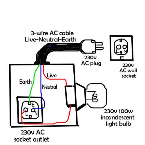

Mains light bulb tester
You need:-
plug top
socket outlet
bulb holder
3 core cable
2 core cable
Connect all three cores at the plug top.
run 3 core to socket outlet
Connect neutral and earth at the socket outlet. Leaving live ready for next connection.
Connect 2core to bulb holder.
Run 2core from bulb holder to socket outlet.
bring the 2core live to the spare live on the 3core
and the bulb return to the live connection on the socket outlet.
Insulate everything or preferably fit the socket and bulb holder into a back box.
Place a mains bulb in the holder.
Leave the socket empty.
plug in and switch on.
The bulb should be unlit.
switch off.
plug a known good unit into the socket outlet.
switch on.
the bulb should flash briefly or not at all depending on the current draw of the good unit. The unit should operate normally if the bulb does not glow. If it glows the unit may not operate as intended. try fitting a bigger bulb so that it does not glow.
Remove the bulb from the holder and the unit should go off.
tester is working.
Go ahead and plug in your amp and switch on.
If the bulb glows strongly then decide if this is due to a fault in the amp or if the bulb is too small.
While the bulb is glowing there is a little voltage in the amplifier.
You can take measurements and possibly identify what is wrong. But all voltages will be way below operating levels.

Hi
Thank you for your help. This post is to confirm if I have correctly understood the "light bulb trick". The wiring scheme is in the attached drawing. Is it correct?
The use of this trick would be this way: After soldering the new PSU capacitors (100+250+250uF at 500V), the first power-on of the amplifier wouldn't be with it connected to the wall socket, but connected to the AC socket outlet of the "light bulb trick" box. Thus, the caps would charge slowly at a reduced voltage because of the series-connected 100W bulb. If the bulb doesn´t glow, all is ok in the amplifier. After a while (perhaps a hour or so) connected this way, I would turn off the amp, and then (after 30 minutes or so) I would reconnect it, now directly to the AC wall socket: this time, with the caps not deeply uncharged (as they are when new), the inrush would be less severe. Is all the above correct? Please tell me if there is something wrong (a mistake here would be very dangerous).

yes, the wiring is correct.
It will not take an hour, ten seconds will tell you if the initial bulb flash is going to extinguish.
Once you have established that there are no catastrophic wiring errors you may have to experiment with bulb wattage.
Start with low wattage and try higher watts until the amp appears to get at least 50% of full working voltage. A classAB solid state amp gets about 90% of working voltage through a 60W bulb.
Remember, since you are on valves to connect a dummy load!
