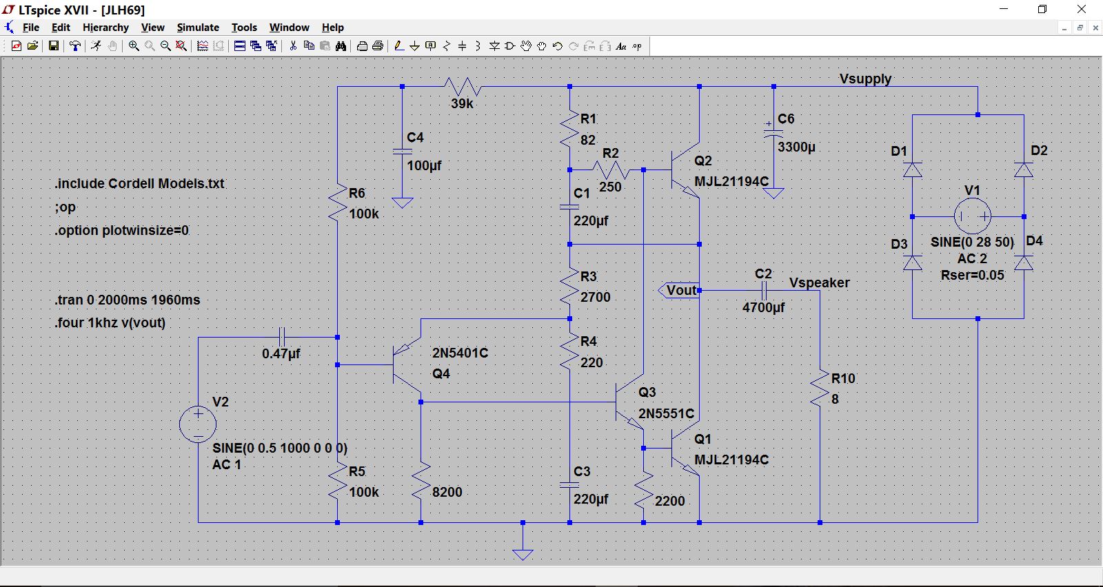

This might help by showing it graphically. This is the well known JLH69 with a 3300 Nichicon reservoir cap. Look at the peak ripple current the cap sees.
There is a lot of info on the graph. Speaker voltage, supply voltage, ripple current in the reservoir cap and the emitter currents for the two output transistors.
The last graph is with no signal applied.
