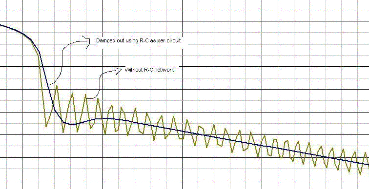

works as an R-C filter - while the cap sets the frequency we want to allow to pass (Pass seems to be omnipresent here...) the resistor sucks the life out of the passed noise signal. In stead of putting caps over the bridge rectifier diodes I put put the R-C combination over the positive rail and GND and mirrored it between the negative rail and GND just after the bridge. Below is a circuit with the results. This works extremely well for my small-casing amps where radiation noise is very unwelcome.

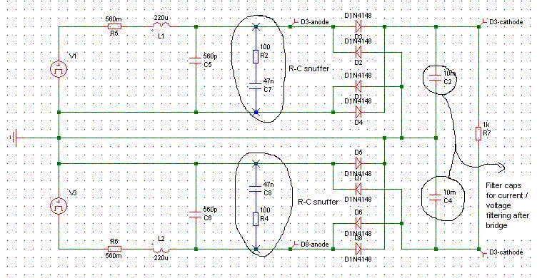

Notes on the circuit below: The circuit represents 2 secondary windings of a transformer giving AC voltage (V1 and V3). R5, R6, L1, L2 and C5 and C6 represents the transformer winding resistance, inductance and capacitance. These values depends on the transformer used and can be calculated. The frequency of the ringing generated depends on these values but are generally in the high kHz or even mHz. The R-C snubber combinations are R2 / C7 and R4 / C8. I chose these values because they will start damping out at fairly low frequencies and they are easilly available.
Please feel free to give your input - I think if the values are chosen correctly then it is a simple way to achieve a good purpose. If you guys can suggest alternative values for the R-C combination that would also help...

Hi, vossie
In your model diodes D1 and D5 are shortened, diodes D4 and D8 are useless (parallel with caps). If V1 has DC offset, than diode D2 is useless too, if V1 hasn't offset (only AC), than huge current will flow thru D2 (short generator connection for negative signal)( Same analysis for D8).
This model represent only half wave rectifier (one diode in each bridge is active ......... and make noise)
R7 must be smaller too.
IMHO
Regards
IMHO
Regards

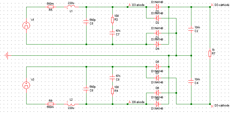

His only error is that
-the 2 secondaries are connected
-and they are connected to ground
remove the connection between the 2 secondaries, and theyr connection to ground
BTW, you seem to use simetrix. What kind of analysis did you perform? I didn't manage to get the same results as you
moamps - you're right, my apologies, the connection between the two primary windings should not be there and should be like the included pic.

Best is to use a short step time (1u or so) and start looking recording data a bit later into the simulation. End result is still the same...
