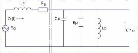

I want to simulate a 2way crossover network I designed through PSpice and measure impedance, but I don't know how.
You would have to replicate the impedance curve of the drivers
with other modeled circuits as well. To see the crossover behavior.

You would have to replicate the impedance curve of the drivers....
It is fairly easy to replicate the impedance curve if you have the T/S parameters of a driver by calculating the following:
- Le and Re
- Ts = 1 / (2π Fs)
- Cp = Ts Qe / Re
- Rp = Re Qm/ Qe
- Lp = Re Ts / Qe
However, still there's still a problem. The acoustic load is not modelled and the impedance curve changes (somewhat) when the driver goes into a box. Even if you somehow manage all that, the SPICE simulations would still show you only the electrical slopes that result.
