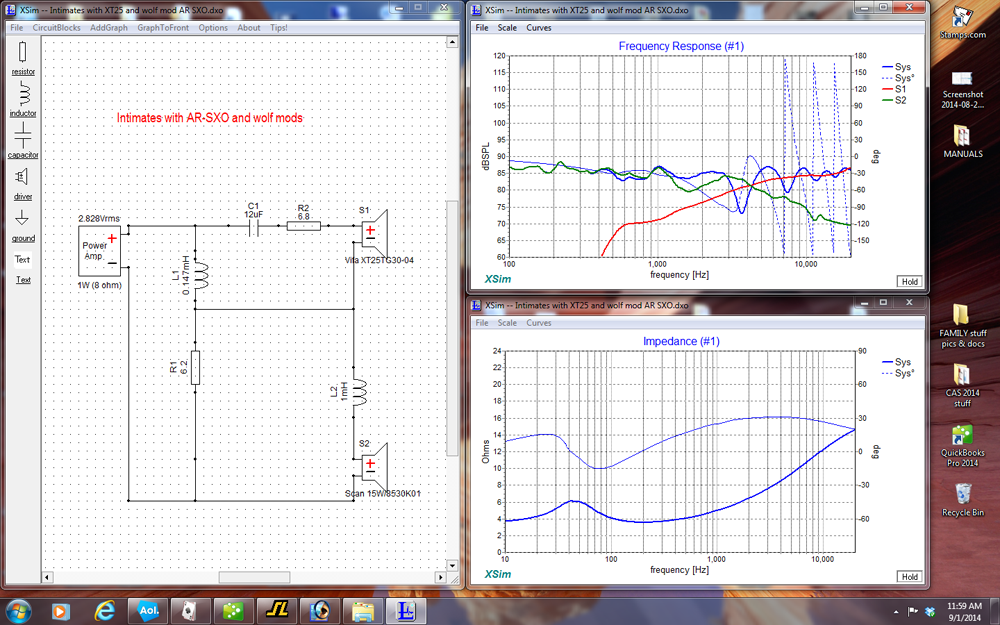

In the upper right FR #1 chart, click on 'curves' and click on s1 and s2. each driver FR will appear separately like those shown below in red and green.
This approach is rather limited. You need to have acoustic and electrical measurements of the driver in the loudspeaker box for accurate modeling. In SPICE you can only model the TS equivalent circuit, which is accurate around the resonance region (e.g. Fb). This model does not take into account what happens at higher frequencies, both from the driver itself and the box edge diffraction (baffle step).
But if you insist, it is a fun exercise. Look up the equivalent circuit for a driver and utilize the published values to set R,C,L in the model.
