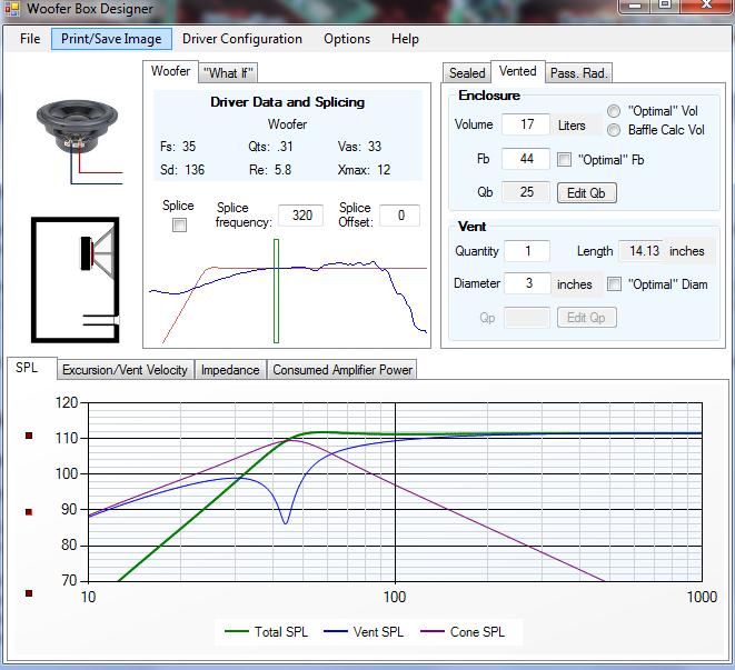

Wow - much easier to use than the Excel version (though I am no expert at that - use Visatons Boxsim quite a bit) - nice features and very intuitive.
One small thing - I think the coloring is backwards here for these graphs? (Vent and Cone output colors swapped in key??)
I just wish there were more FRD and ZMA files available that had PHASE info! THANKS for creating and posting this :cheers:
(would there be value in adding a function that could generate rough phase info from the TS parms and the Le value just so one can do rough sizings ahead of buying a driver and measuring it oneself?)
Thanks. I spent a lot of time trying to make it easy to use and "intuitive". I'm glad to hear that others find it easy to use 🙂
Yep--I'll fix that in the next release. Thanks.
