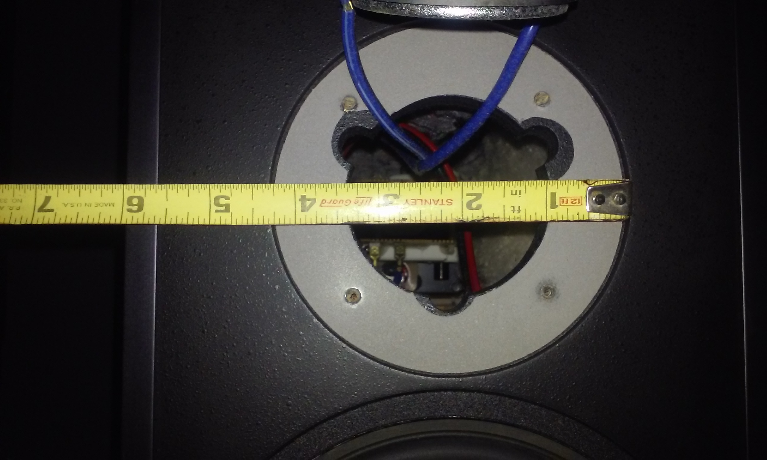

Hello,
I'm looking for a direct drop in soft dome tweeter to replace the aluminum tweeters in my psb Stratus Mini's. I want to keep the overall balance of these speakers intact as I mostly like them, but would prefer them to sound less metallic and have slightly less high end energy ( I listen in the nearfield in a small bedroom). From what I understand I may have to add a resistor to lower the new tweeters a feq db's. I'm looking for a laid back musical smooth tweeter that is somewhat forgiving of equipment and poorly recorded music. Basically the same performance as my current tweeters but a silk/soft version. The current tweeters are Vifa d19ad-08 6ohm and I've attached a few pics in case this helps. Thank you in advance for any help.

A new tweeter has the potential to sound like anything and solve nothing. Also metal dome tweeters don't sound metallic either and it's as Lojzek says above a crossover modification is what would really be needed.
2-2.2kHz as an xover frequency seems a bit too low for that tweeter though. It's a 19mm unchambered tweeter. I am sure it would work well at lower volumes but turn it up a bit and I cannot imagine it being quite so civilised.

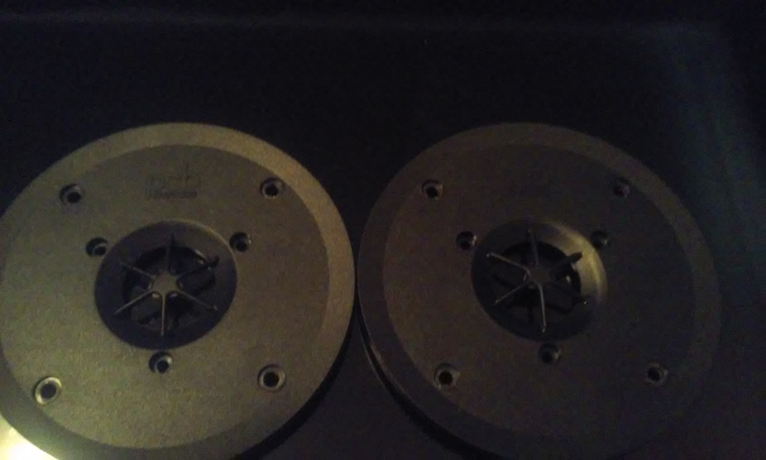

Well, since I've already committed to changing the tweeter anyways I snipped off the plastic "diffusers" or whatever they're called. This mod has been mentioned several times on forums by Charles Hansen who I believe once designed speakers. Also, Pierre Sprey of Mapleshade recommends this on his website. There is definitely a change in the sound and am still deciding if it's a positive one. Allegedly the only function of this plastic plate is to resonate at a certain frequency.
No, that's not what a phase plug does. Removing it may drop the very highest audible frequencies a bit, but could also make the ultrasonic metal dome resonance stronger due to losing some damping.
Since you have essentially ruined the tweeters, go ahead and replace them with whatever ~6 ohm tweeter strikes your fancy.
Yes the plastic phase shield is supposed to block the sound coming from the tip of the dome which is out of phase with the sound radiating from the outer perimeter of the dome. Effectively it gives you a more extended and smoother response at the very top end. Removing it likely just gives you a severe null in the top octave which will probably make them sound a bit duller than they would otherwise.
You don't see this on non-metal domes because they experience breakup modes which change the phase/amplitude of the tip radiation, at least partially fixing the problem.
I cut the plastic phase ring off carefully so that I could glue it back on just in case the mod didn't work out. This was for sure a risky procedure but I've owned two different pairs of these speakers since 2004 and have always wondered about this tweak. The speakers definitely don't sound "ruined" now and would almost say have more fluid sounding treble than before. I still need a few days of critical listening before I complete judgement.

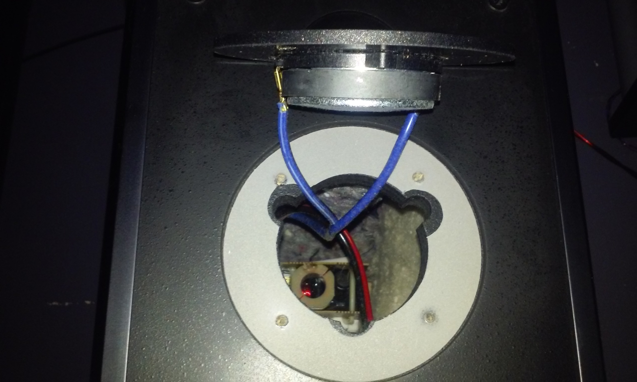

Here's a tweeter I was recommended by someone-http://www.amazon.com/Vifa-D27TG-35-06-Silk-Dome-Tweeter/dp/B002WCSXQC
In addition I would also like to lower the high frequencies by a few db's. I really think my room is just too small for this type of speaker and that my ears are extra sensitive to metal tweeters. I've read someone else who has sucess going this route with psb Stratus Silvers so I think I'm on the right track. I'm willing to work with this speaker because I like %90 of it's sound and love the way the cabinets look in black gloss.
After some intense listening sessions I came to the conclusion this "mod" wasn't for me. For some reason removing the phase ring gave me MORE treble which is the exact opposite of what I
wanted. Maybe some tweeters benefit from this, but certainty not mine. Carefully I re-glued the rings back on the tweeters. Even though this tweak didn't work out, it was fun taking apart my speakers and doing the mod myself. Since the resale value on these is now severely dimin ished, I've decided to make these my dedicated diy project. There is one thing that always bothered me about these speakers is that they are biwirable, don't like to use jumpers ( I feel this is just one more obstacle from the original signal) and am not interested in biwiring. Based on this I've always wanted to solder both wires together to make it a single wire speaker, but have no idea how to do this. Here is a picture of the crossover and if anyone could give me advice id be appreciative and maybe start another thread asking for more specifics.

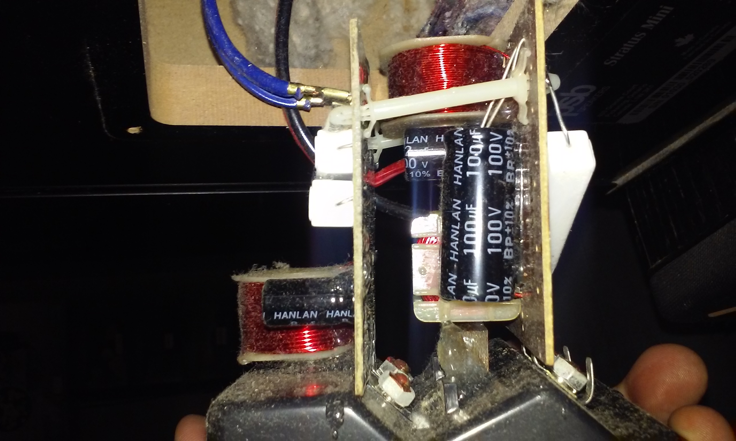

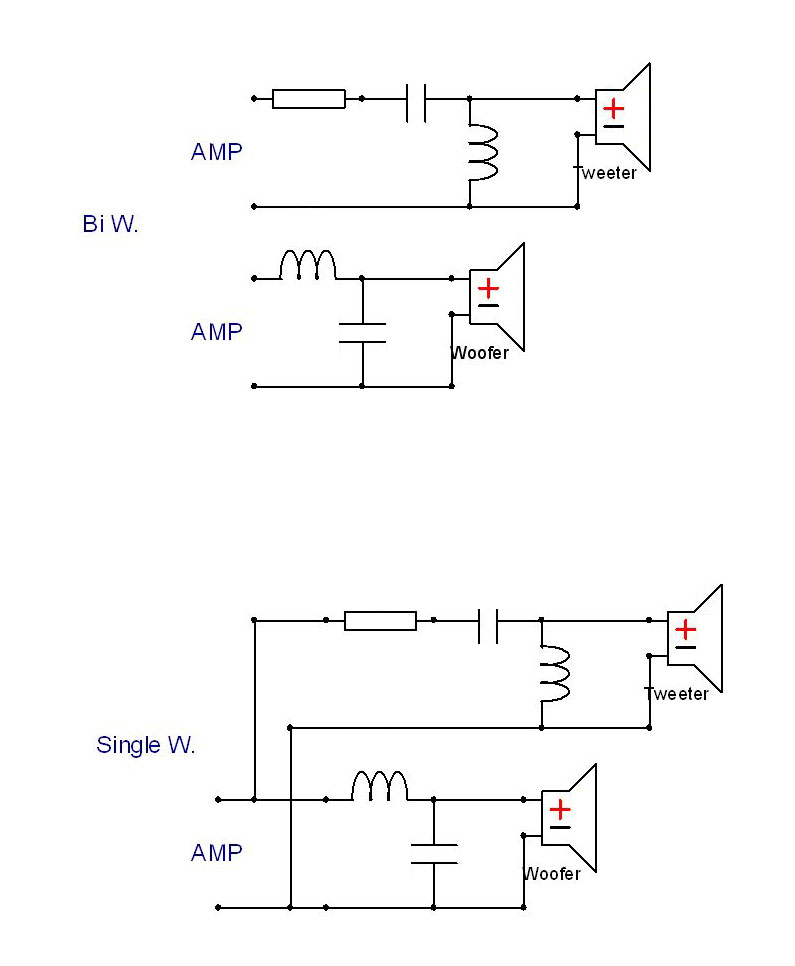

Probably the best thing is to do is measure them and see if something stands out. If they measure well free-field (well away from any boundaries with reflections windowed out) then the next is to measure them in situ and look for changes. If they measure poorly free-field, perhaps the caps need replacing, but doing this without measuring before and after could be an issue. Manufacturers sometimes trim or hand select component values in speakers to get them to match better.
Worrying about biwiring straps messing with the signal is silly, even more than just willy-nilly cutting off a phase plug.
Your speakers were carefully developed in an anechoic chamber in ottawa. The right way to go about modifying is to measure, tweek, measure and listen. Try to correlate what you hear and measure. You might become a better listener.

Your best bet is a tweeter replacement. The ring radiators XT19 and XT25 would probably work for you, but being able to do so without rework in the crossover would be a real stroke of luck.
The Tymphany/Vifa XT25 ring radiators would fit in that space, they'd be actually a little small, they use a 4 1/8" flange cut out, and 2 7/8" or so hole. Extremely smooth and flat. On the plus side the line is inexpensive and crossover well down to 2 kHz or so. The dual magnet XT25 even lower, or the same with possibly lower distortion.
